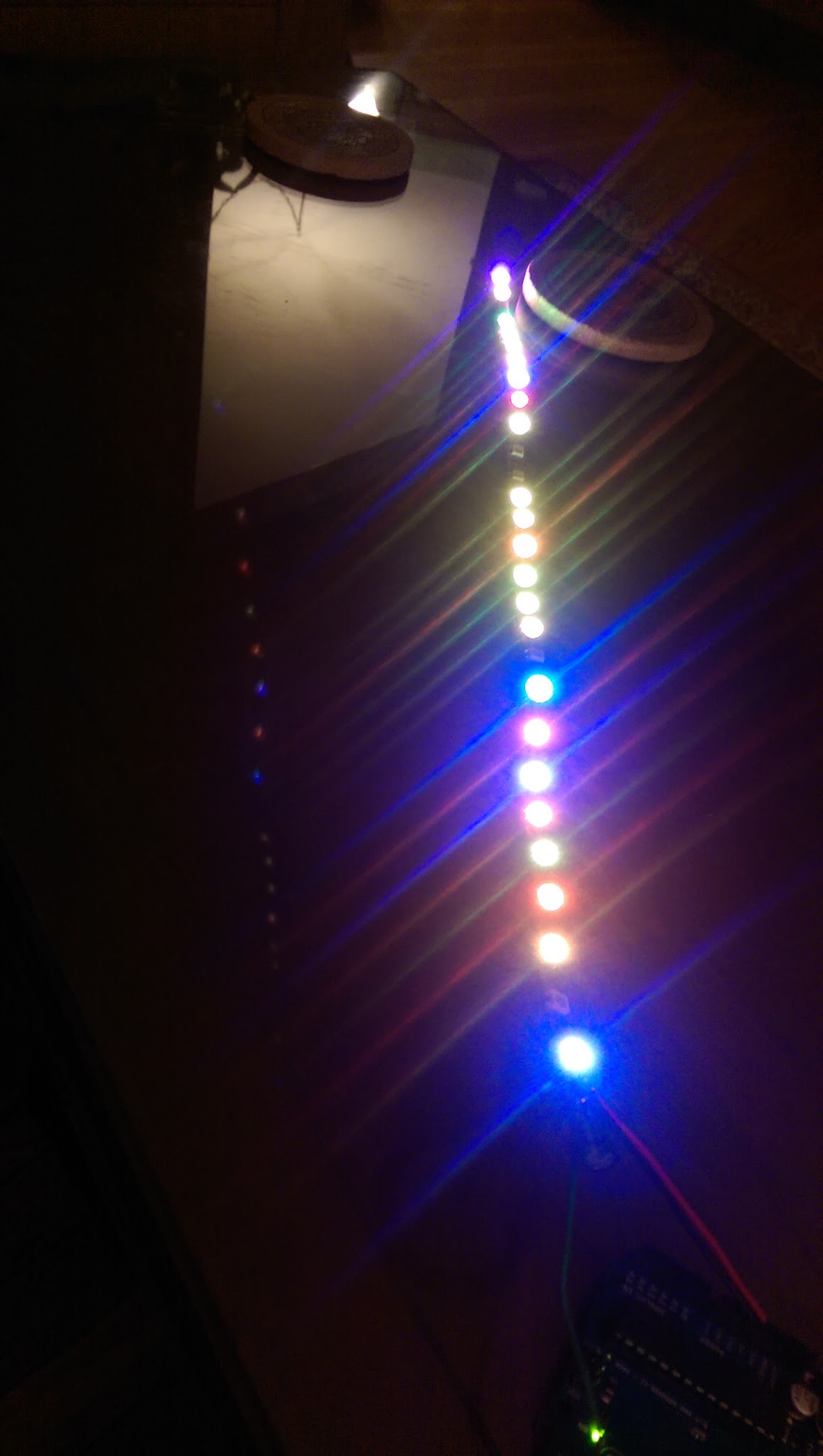

I’m trying to learn/teach through some FastLED tutorials, and was playing around with various ways to make a pixel go back and forth or cycle a strip with a fading tail behind it. I was going to give fadeLightBy() or fadeToBlackBy() a try, but get really weird results! Here’s the code:
void loop()
leds[lead_dot].b = 255;
lead_dot = lead_dot + 1;
for(int dot = 0; dot < NUM_LEDS; dot++)
leds[dot].fadeToBlackBy(64);
FastLED.show();
delay(20);
It runs a couple of blue pulses and then just freezes for a bit before turning the pixels a bunch of yellow/red tones (attached pic, though as you can figure it’s hard to capture). Then it literally acts “laggy” when it resumes and the lead pixel/tail stop toward the end of the strip indefinitely.
If I simply replace the fadeToBlackBy() line with this, it’s fine:
leds[dot] /= 2;
Why can I divide all channels by 2, but not use fadeToBlackBy()?

Hmmm. Your use of fadeToBlackBy had me look up the docs. I was following the github wiki which just seems to pass the function a fractional amount to fade by. Your code (and the 3.1 docs now that I checked) pass it the array, num_leds, and a fade value. Maybe the issue was mixing old function syntax with v3.1?
You can fadetoblackby a single LED or the whole array. Oh, and I currently keep all my tips, tricks & traps at:
https://github.com/atuline/FastLED-Demos/blob/master/fastled_tips_snippets.ino
Thanks @Andrew_Tuline ! So, couple of revelations… while I’m ~99% sure I had it at one point, I don’t have a line like if(lead_dot > NUM_LEDS - 1) { lead_dot = 0; }! I think that’s what was glitching things. Not sure about the internals of FastLED, so I’m not sure what happens when it sends data including values for a pixel that doesn’t exist in hardware. Using that line fixed the issue.
I also confirmed that both variants of fadeToBlackBy work (the one inside the for loop above, as well as removing the for loop entirely and just using fadeToBlackBy(leds, NUM_LEDS, amount) each loop.
