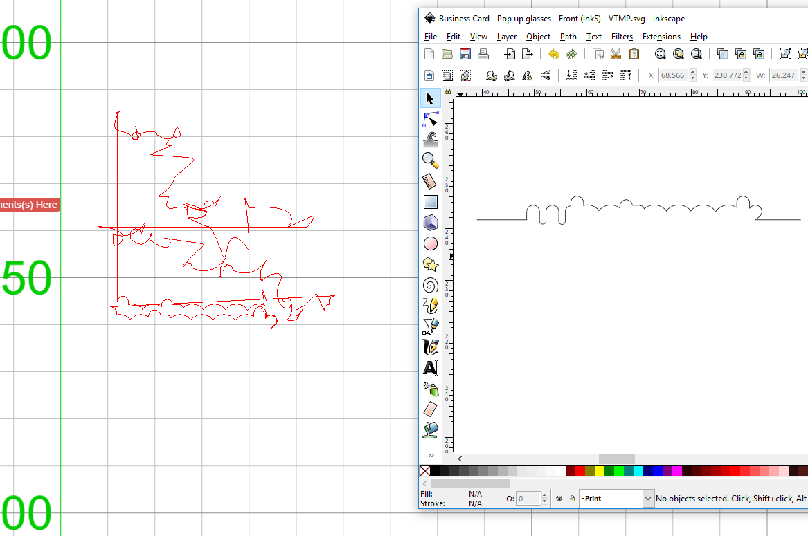

I’m trying to make the move over to inkscape from coreldraw to improve the compatibility of my drawings with LW but I’m having some major issues. I’ve created a line I want to cut using inkscape (using text and then Path - dynamic offset to create a contour, then slicing the path so just the top half is remaining). LW seems to do something crazy with it. I’ve tried this multiple times with brand new files and get similair results. I’ve attached a screen shot. Any ideas?

@Jeff_Lamb can you post the file please
@Jeff_Lamb this is something out of this world. I have been able to make it work somehow by re-saving it on illustrator but does not know
how you got there. @Todd_Fleming if you can take a look at this

I just pushed a fix. We were on an old version of snapsvg.
That new SVG interpreter fixed a few things for me! Thanks again guys!
