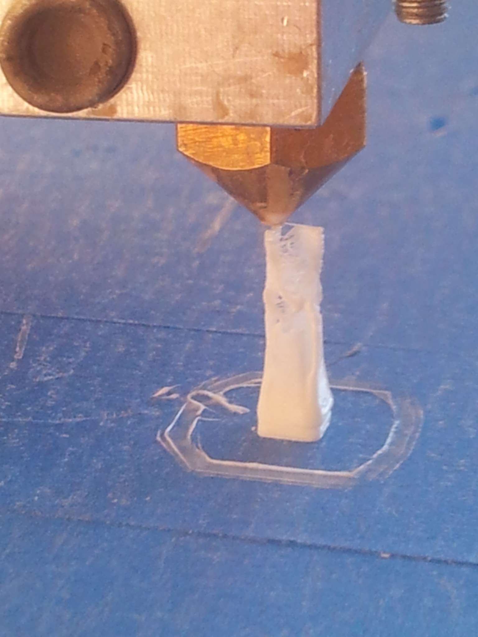

I’m trying to print a simple 4x4mm hollow square column with Cura. Starts out fine, but then holes appear in the walls (0.6mm thickness, 0.1mm layer height). Apparently not enough PLA from the feeder?
Any tips on how to achieve a better print? I already raised the temp 10 degrees and lowered speed and the filament thickness a bit in Cura to increase extrusion (I think). How would you prevent holes in the walls?

It’s heat. there is not enough time for the layers below to cool and thus they are slumping. When the head pases over for the next layer the gap gets bigger and bigger. You will need to drop the heat to 185 for PLA (use a bit hotter on base layer) and have a fan blowing on the part. Also slow the speed to 10mm or less.
A short (low quality, sorry) webcam clip showing the hollow column to fail at the top, after it can’t deposit plastic on starting gaps. Also it starts out at 4x4mm and gradually starts to shrink at every layer it seems.

Add some cooling to increase the strength of the previously deposited plastic, slow down to let the previously deposited plastic cool and strengthen. Maybe reduce the temperature to deposit a firmer layer, especially if there are hairy, liquid threads drifting around.
Would you get the same gapping with a larger 8x8mm less wobbly column?
@David_Forrest Ah, good idea, I hadn’t thought of a 8x8mm one to test it. I did try printing 3 columns at once though, giving each column more time to cool. Which produces results that are a lot better. Printed at 185C, speed 20mm/s, and layer 0.2mm:

Tried it with 3 columns at the far corners of the printing bed (so the threads would maybe break?) at 0.1mm layer height, but that was horrible again, holes, not enough extrusion…

0.1 mm layers, also possibly printing multiple of them to escape any cooling issues. But before that I would try a single one. Depending on your desired wall thickness I would go for one to three perimeter lines (e.g. 3 * 0.4 mm = 1.2 wall thickness). If you’re in for just one perimeter line you should definitely try the “Joris the outer edge mode” in the expert settings (up in the top navigation bar), because then you have a continuous Z travel - very nice!
Fan: Full speed! Possibly I would add another ventilation device next to the printer - that could fix all your troubles.
Speed: Try to find a speed where it doesn’t end up in a big molten mess. It shouldn’t be too slow (or the nozzle will remelt everything) and shouldn’t be too fast (or the new material doesn’t have time to cool down).
Temperature: Go as low as you can comfortably print. This really depends on your filament. I’ve seen good PLA which was still coming out great at 185 °C, but first I would try 190 °C or something more “secure” (in terms of not risking that there’s too much pressure in the nozzle).
Hope that helps! I’m in the middle of a print, otherwise I would give it a shot. Try single walled (0.4mm nozzle setting + 0.4 wall thickness + Joris mode on) - that could be perfect!

@Florian_Horsch_flouS Right, I’ll try three columns (for cooling) at 0.1 height, 0.4 wall, 185C, 20 mm/s speed, 2.90 diameter, 70 mm/s retraction of 4,5 mm and 3s min. layer time. Have the latest firmware via Cura (nov 2012 ultimaker). Printing… nów!
And cancelling because the first layer didn’t stick at 185C. Will do first layer(s) at 200C, then go down to 185C.
@Florian_Horsch_flouS Looking better already
Changes: lower speed, increased diameter from 2.89 -> 2.90, retraction turned on.
Ok… probably still a bit too much material (try 2.91 or 2.92 ?!), also I had sometimes better retraction results with highter temperatures (not really intuitive… so you could also try 200 C for the whole print).
And probably the best tip: I would arrange those pillar not in a row. Otherwise you wipe the middle one too often, right?
Also check the retraction as discussed above (I don’t like the tiny stringing on your pillars. That shouldn’t be the case.
Do you have “joris” on?
Good progress!
