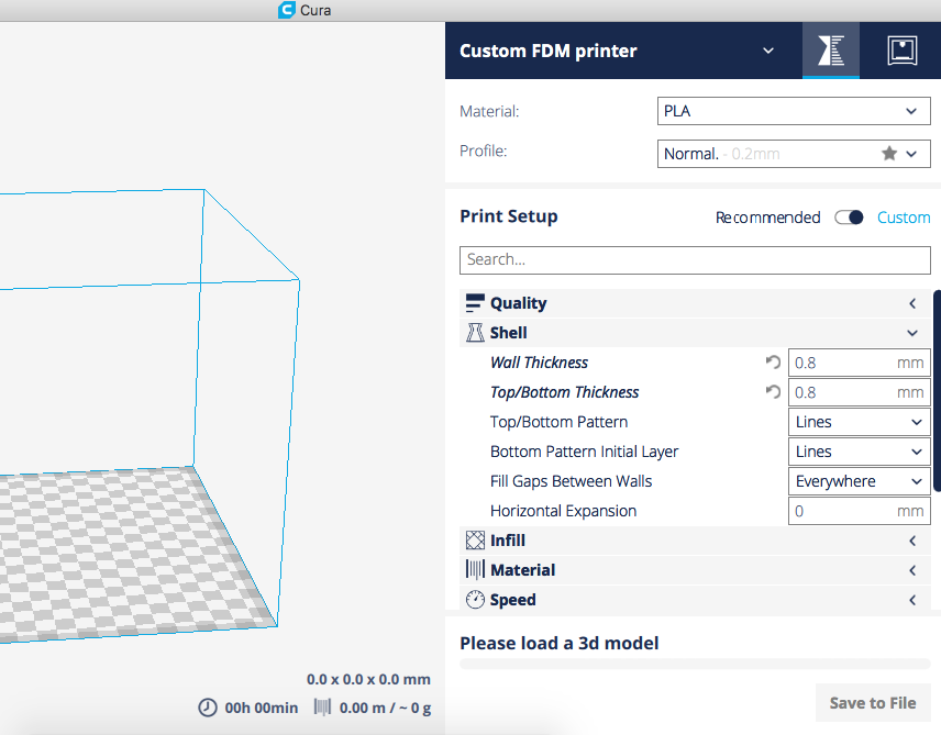

What slicer are you using? Cura has a Horizontal expansion setting, that will offset the mesh for such instances.
I’m using Cura. I can’t find the Horizontal expansion setting. Where is it? I’m using version 21.04.
It should be in the shell section. If its not you will need to click the little gear icon next to shell, then under shell check in the box for horizontal expansion.
