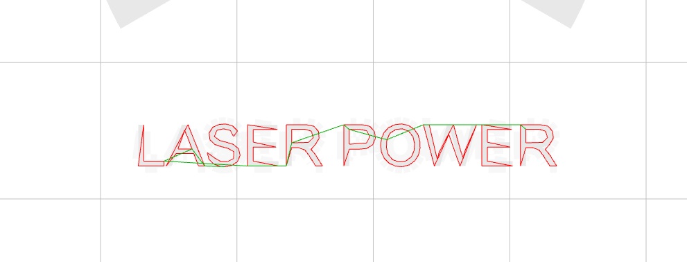

@Lance_Ward Todd the developer fixed the issue and created a safeguard. Look at the image bellow. By default you will have the correct path generated. If for some reason you see that you machine chokes ( smoothie only ) then theres a new option called segment. The value by default was 0.5 and that was what you where seeing. Now its 0 to get perfect path. Again if your machine is smoothie based and it chokes then play by adding 0.1 at a time until satisfied or you get a broken path.

I used the fill and that worked pretty good. See image below. I’m not using live version so I’ll wait until someone updates the binaries. Thanks!
