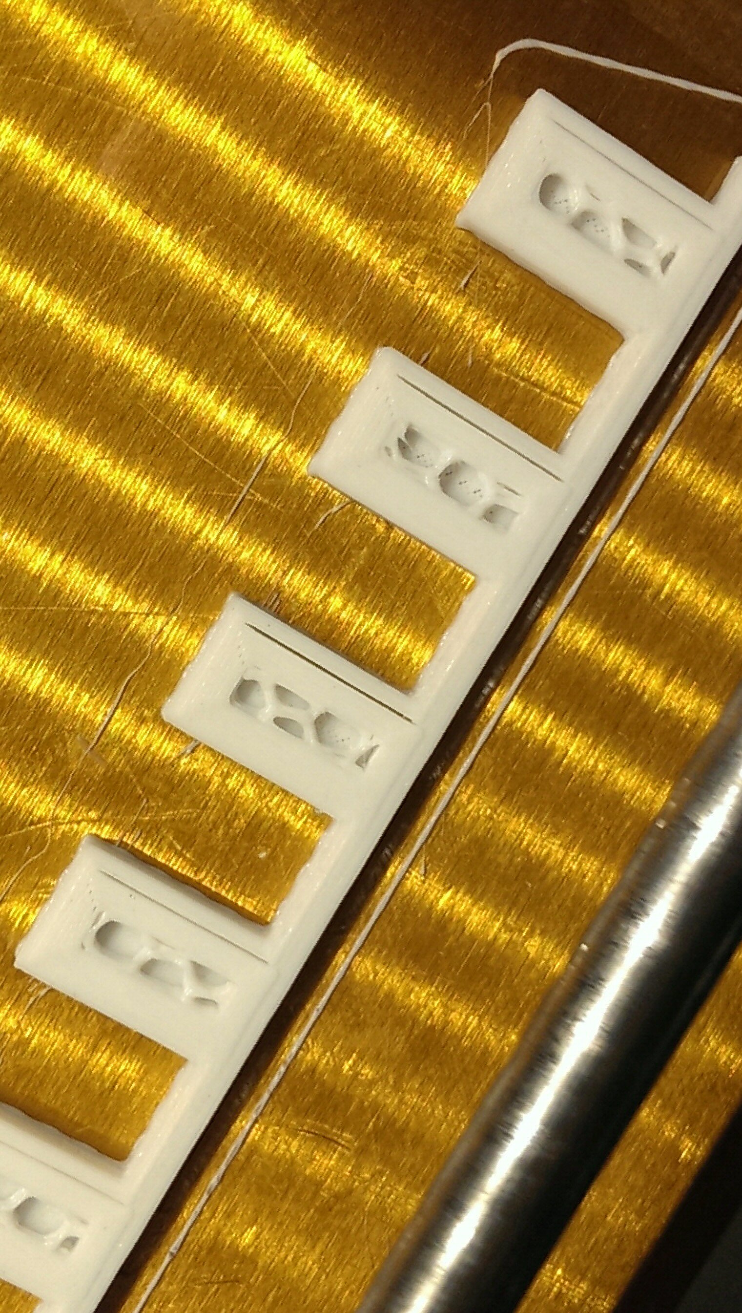

I'm using solidoodle 4, and I'm having that space.
I’m using solidoodle 4, and I’m having that space. Is that space caused by the printer or my slicing setting ??
I really in need to fix that, thank you
The slim line between your permiters? That could be lash/backlash because off to loose belt.
@Jesper_Lindeberg Yes that slim line, so I have to tight the x-axis belt, isn’t it ?
What slicer are you using?
yep x-axis if that’s one on the picture in lower right corner.
@Stephanie_A I’m using slic3r
Slic3r works better if you specify the extrusion width.
Okay, thank you @Stephanie_A @Jesper_Lindeberg
I also set the extrusion width manually in Slic3r.
I like to use Sublime’s calculator to find the optimal extrusion width.
