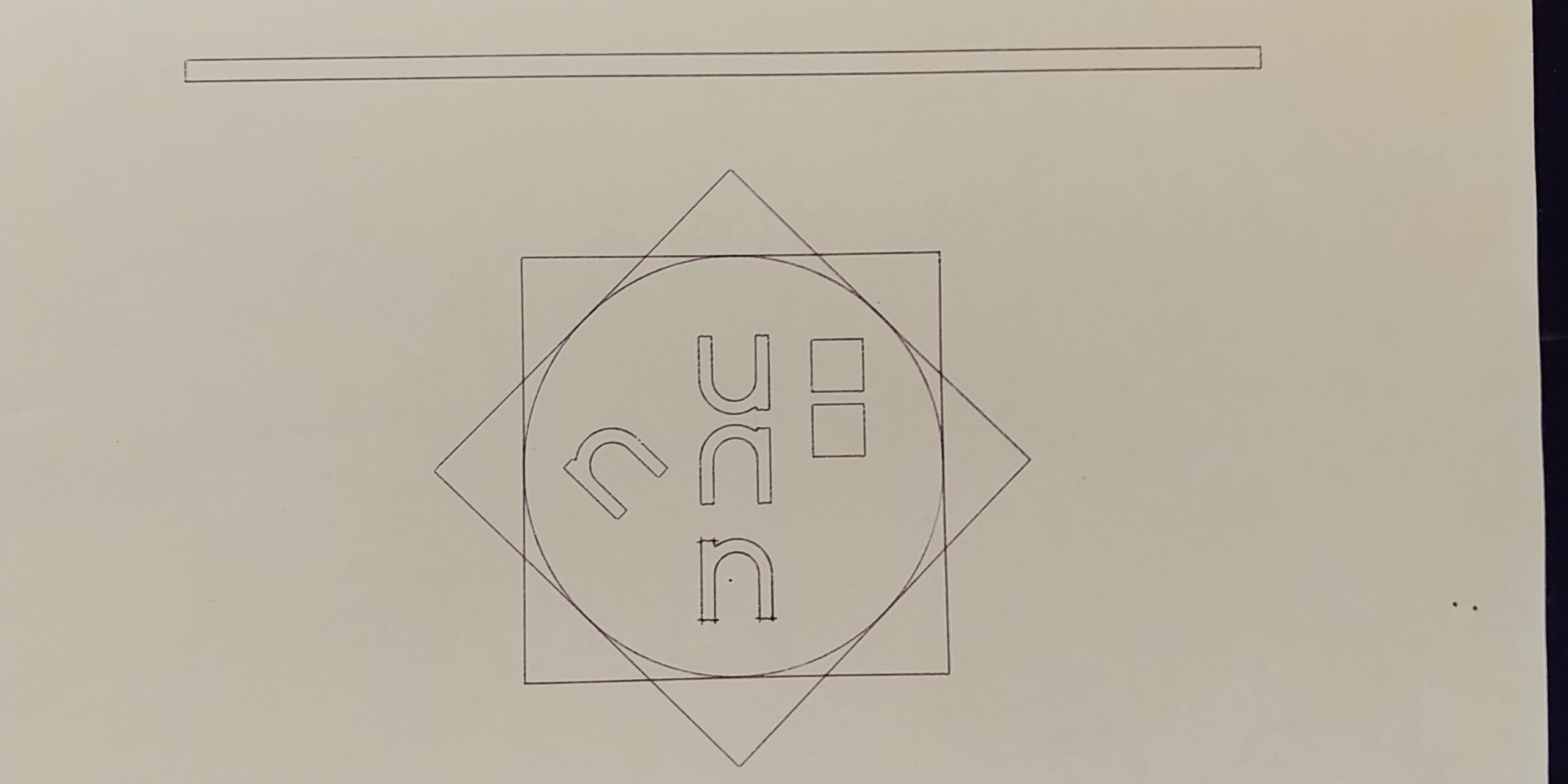

Hello everyone. I need expert help please. I have problems with horizontal cuts. As you can see in the image, the horizontal cuts are not straight. You have much better quality in your K40 right?

The modification has been partially successful. Horizontal lines are now straighter. Maybe in the photo it doesn’t look so much but this is because the test is done on old paper and the surface of the bed is not completely flat. Where it has been improved but not so much is in the horizontal changes of direction. Especially when it changes from vertical down to horizontal to the left. There is still a small wave. Now it is less but it is still evident. Diagonal direction changes are less of a problem, I’ll eventually have to cut the pieces in this position. I tried the MeerK40t program before the modification because I read that the program corrected this problem but it did not help me. Has anyone used this program and noticed any improvement?

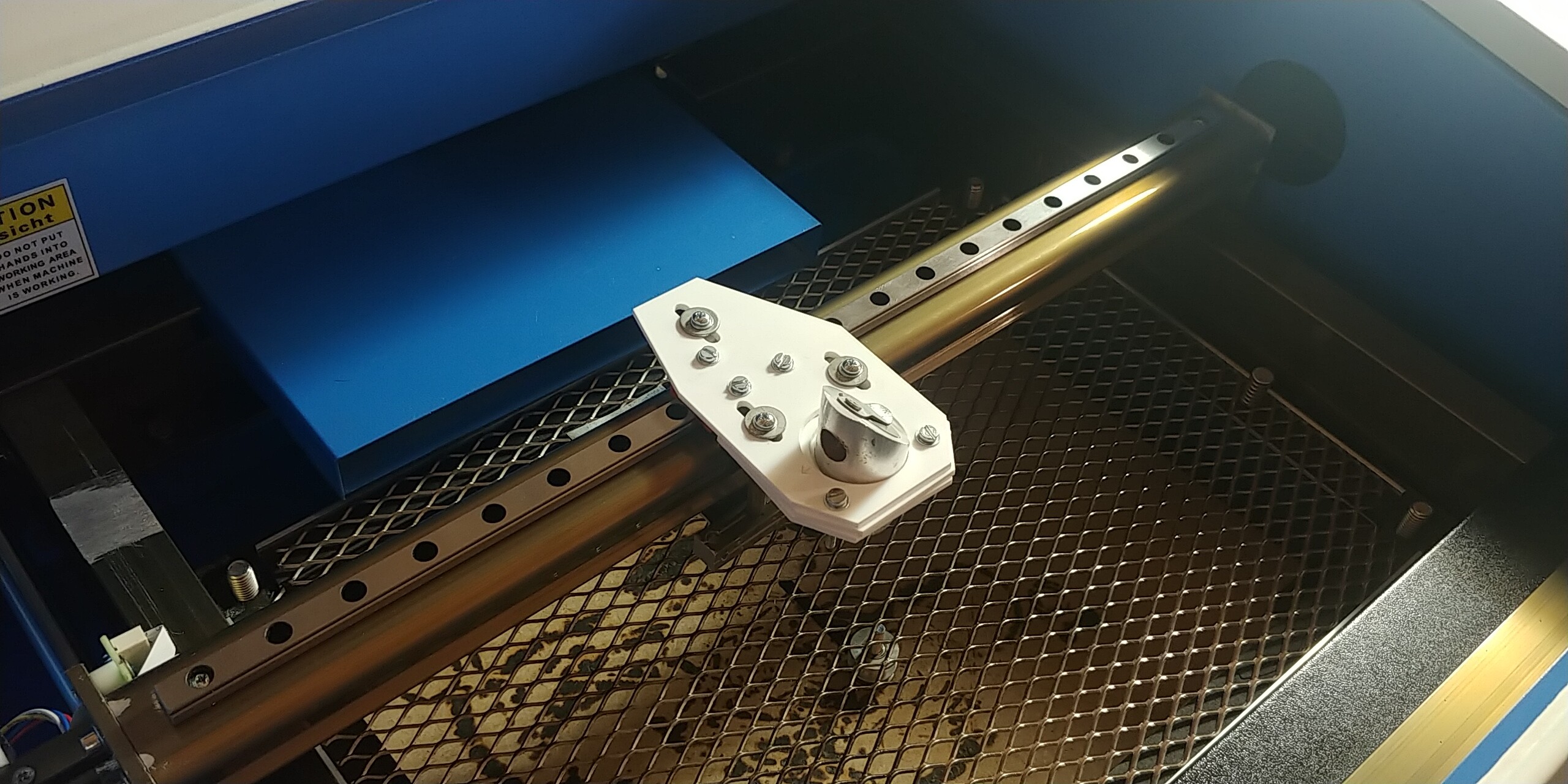

This is how my K40 looks after the update, I need to buy a couple of shorter screws to make it look better:
