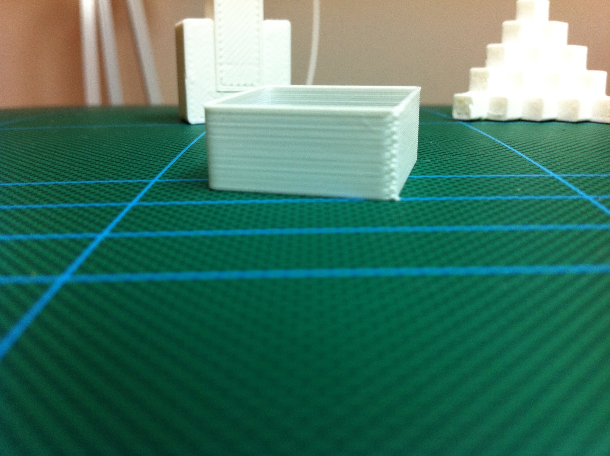

Improvements on the RepRapPro calibration.
- Now the fit boxes fits perfectly.
- The 0.5mm wall is regular almost without gaps, and it is about 0.54 width
- The small step has to be printed using the “cool” function of Skeinforge and a big fan around. Not the final solution but I was curious.
