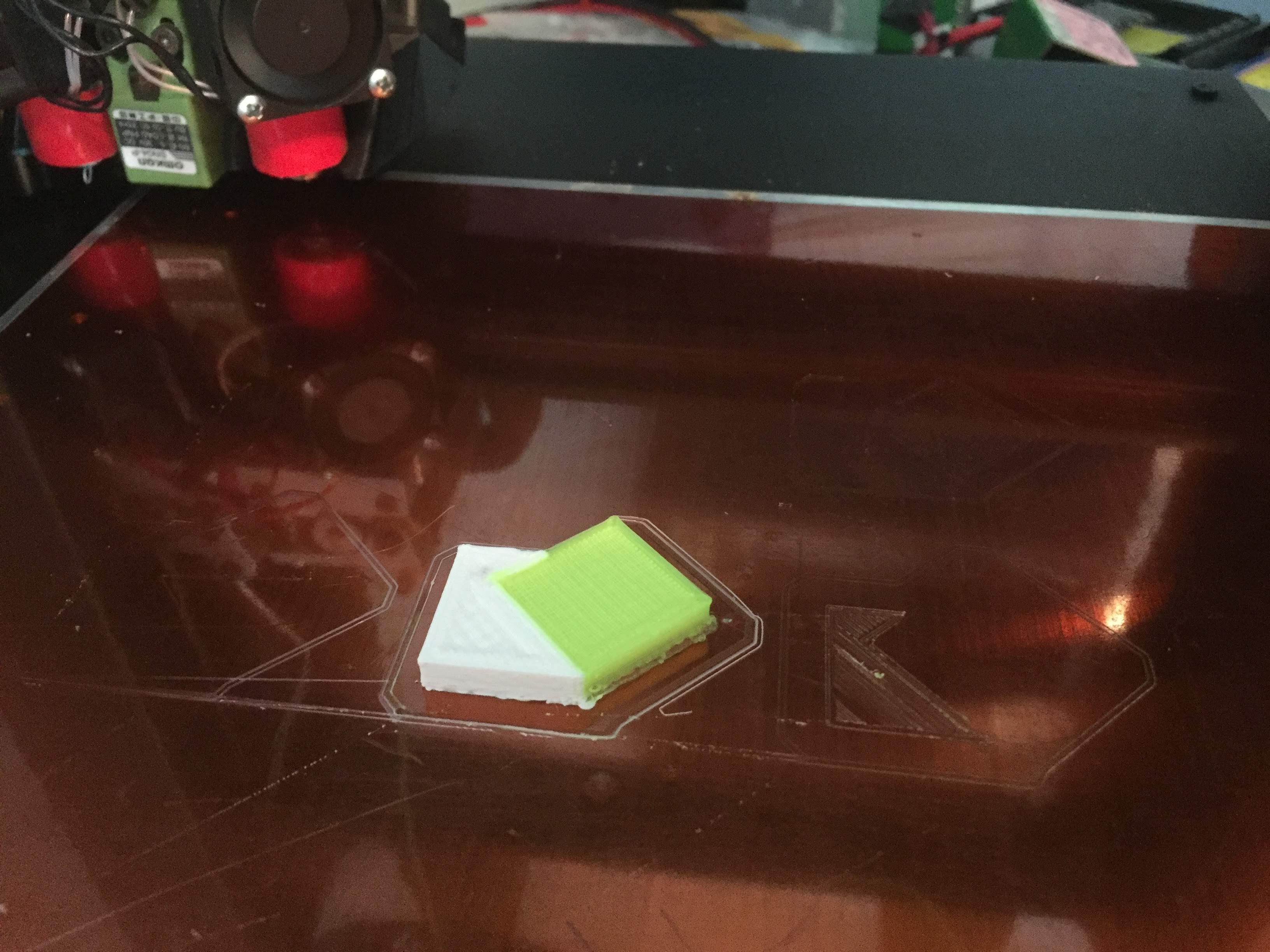

In case anyone has forgotten what dual extrusion entails: You sit there,
In case anyone has forgotten what dual extrusion entails: You sit there, print a little turd, ahem, test piece, like this, figure out what went wrong, change some setting, and repeat for hours, days, or longer on end only ending when the filament grave pile is taller than you are.
