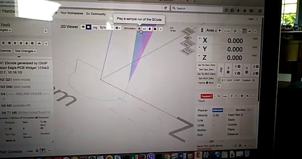

so i just tried a visualisation in tinyg workspace on similar gcode (just in case something was particularly wrong with my workspace). the layers of each cut are being shown but the toolpath is not, and the virtual bit does exactly the same as the reality - it just descends on the circumference of the hole and dose not mill. the same is true on other workspaces, as one would expect.
video here: https://photos.google.com/share/AF1QipMUyg8VwIy1ZIjisGQ_ZD0lDOEHzMTG8vdoi7EdOheSUrHpmxYlVQNDbGplxAFnsw?key=TE9vNmd6NE1DYUcwWkpTMlRoX3NGV2ItRGFoS1lB
the gcode used is partially shown in the video but is just a series of steps and arc:

this is odd.

Here is the same result with a half arc.
Gcode for the arc was g3x3i3
Am i getting the gcode wrong or is somehow grbl and cp getting it wrong?
Sim does not work on the one I ran but it runs fine. I though this was a known issue with arcs.
if it was a known issue, it was not known by me!
it doesn’t run on my machine either, but the last run broke the coupling on my Y axis so no more testing for a while.
