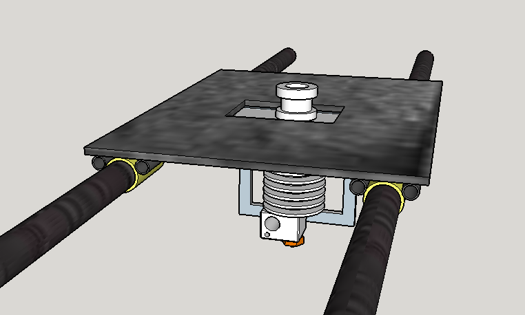

In my quest to further lighten everything possible gantry-wise, I received a bunch of polymer bearings and CF tubes today and they are just the ticket. Not a hint of stiction, even when you twist the bushes on the rods.
I have been assured by the chemical bod at the plastics place that the surface of the bearing is energised enough to take nearly any kind of adhesive - PVA (for fitting in MDF carriages), epoxy, even superglue and hot glue, for testing. so, I’m going to go minimalist and use a piece of 2.5mm CF plate with a couple of 3mm CF tubes for alignment and epoxy the bushes in place The whole carriage should come in under 30g and as we know, mass is not our friend, so it should be right friendly

Nothing like it @Miguel_Sanchez -this is a carriage for a Sli3Der.
I am making it on a CNC router out of MDF, so the tolerances will be close.
The Sli3Der is already fast, even with heavy steel rails. My idea is to get rid of as much inertia as possible and to simplify the build. Cutting a flat-pack from 6-12mm mdf means it will be simple to set up, will be aligned correctly “out of the box” and will be cheap to make ($4 for the chassis, vs about $80-100 for extrusion). plus it’s quick to make. Initial cutting out took 8 minutes from scratch, vs days printing plastic parts.

@Dale_Dunn , it is no more prone to binding than a steel/LM8UU setup used in lots of printers, and cutting out using CNC should make it within .01mm accurate over 300mm.
But… I like the idea of keeping one end of one rail floating. I will look into it. Thanks.
