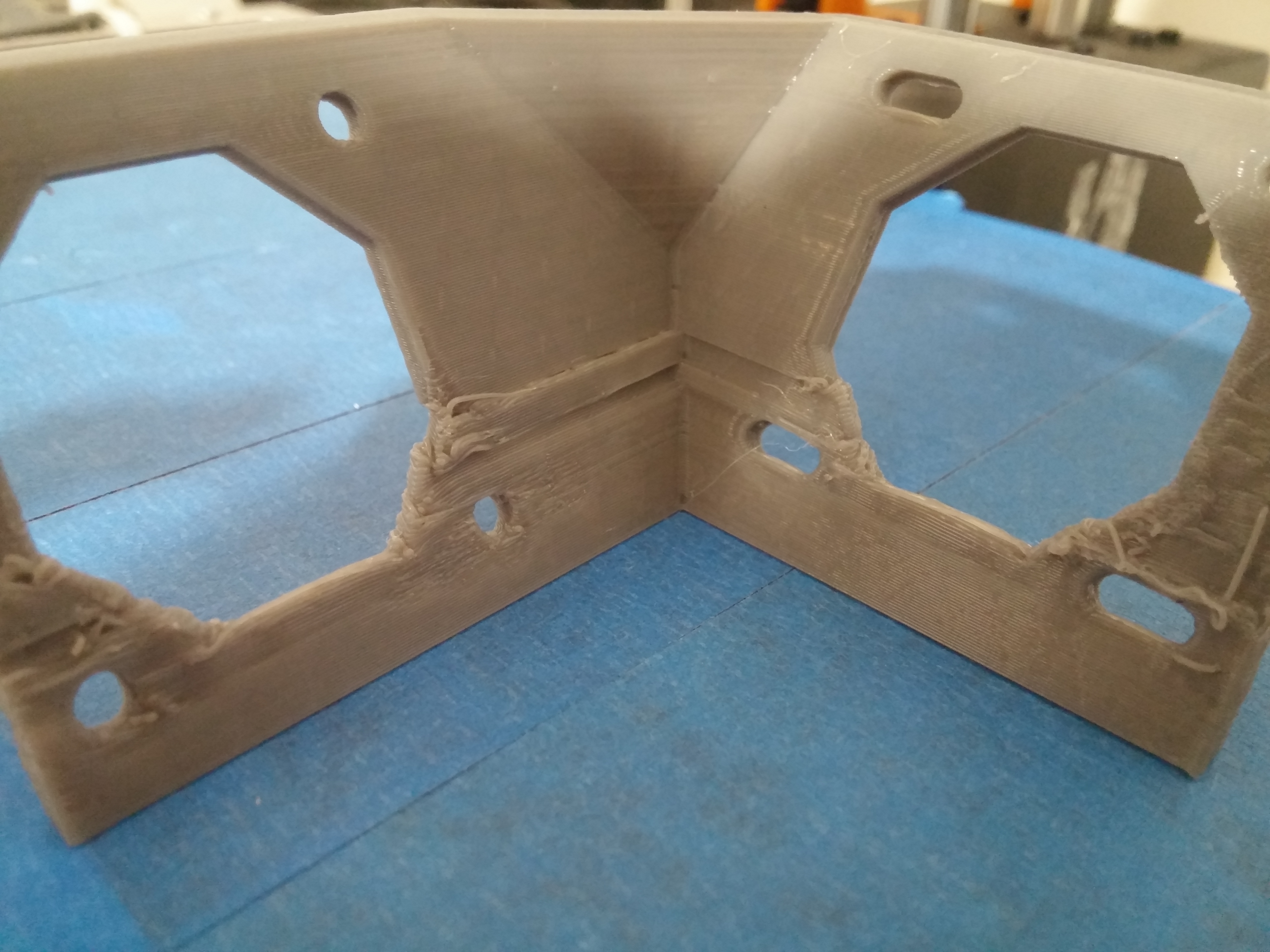

In relation to my last post, this is what I hope to solve with 2 blower fans
It looks like the motor missed a step. It’s not a cooling issue or your 45 degree overhangs would be drooping.
Agreed. Looks like you got a couple skips.
@Adam_Steinmark guess i should’ve explained what had happened. The bad cooling was causing the print to mis-shape which ended up hiting the nozzel making it skip, u can see thr poor cooling in some places just b4 the printer skipped. Btw the picture is also upside down, so it was printing reverse of what you see
Ah that makes sense now.
I think I had similar issues. I tried printing with the part fan off and part distortion disappeared. I suspect skipping might disappear too. Will try with fan at 20%
