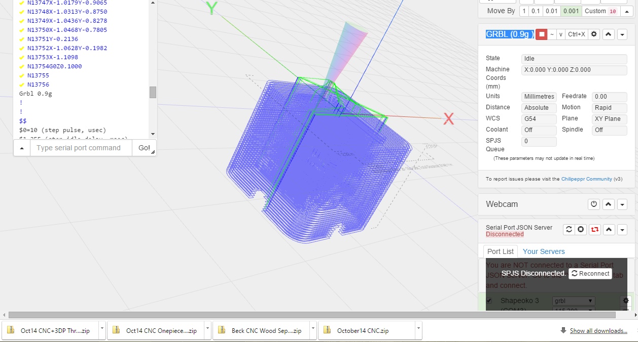

In reply to my previous post I don’t know if this helps. I am running grbl 0.9g. Unfortunately i don’t have the original screen anymore but imagine the buffer would stuck at 6000. If I click on the unpause button or anyother command it would increase the buffer.

Hey Jerret, all the part will be arrving tomorrow. I will do a test and let you know how it goes. I am hoping with the usb2iso usb adaptor it will resolve the issue of my shapeoko 3 disconnecting from the spjs server in middle of the job.
@Jarret_Luft Jerret thanks for the link. I got the ferrite ring and adaptor. My machine isn’t dissconnecting anymore.
I figure could be a loose usb or noise, but it works now. I HIGHLY recommend galvanic isolator adaptor.
