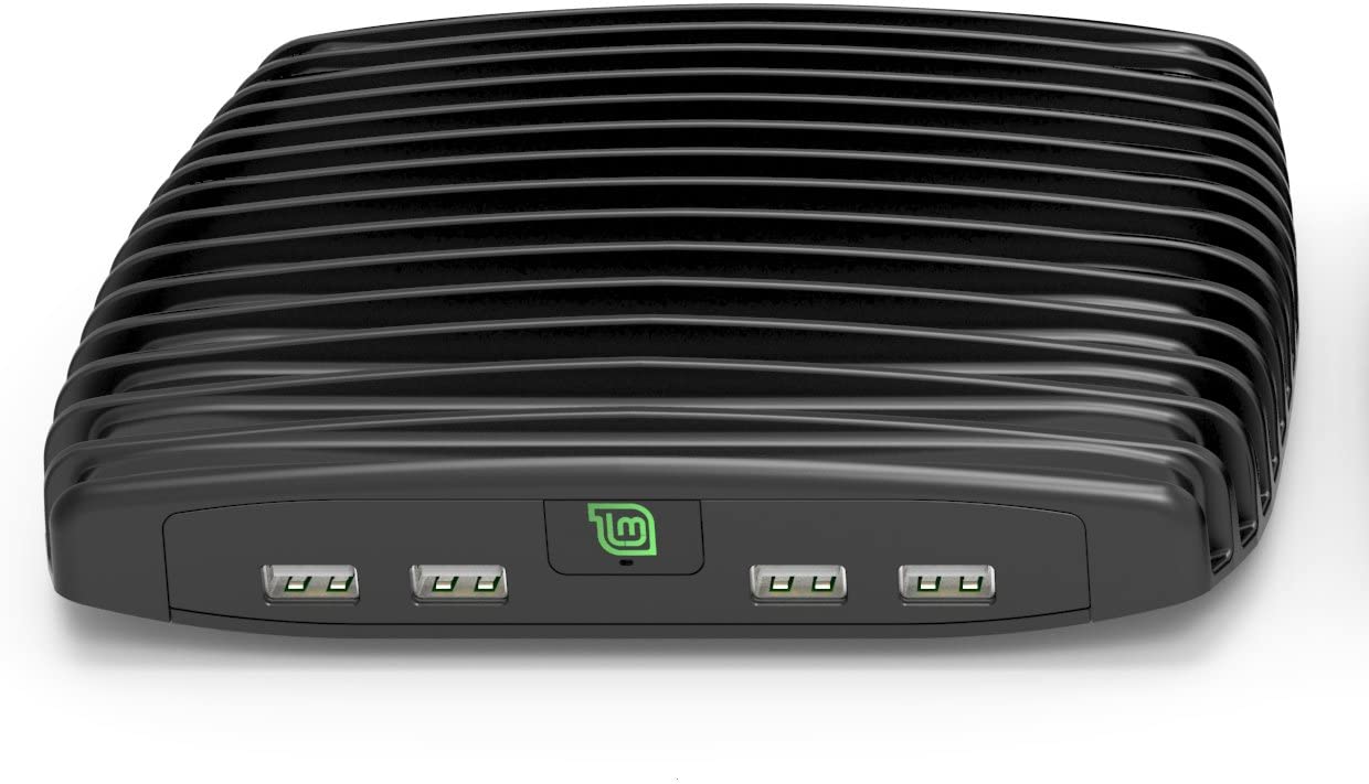

so, one idea i’ve been toying with is a fanless, sealed PC in the garage - no worries about dust, metal shavings, etc. A few things come to mind. One is something like the mintbox or the intense PC line:
that’s completely fanless, and that is a pretty high powered machine.
