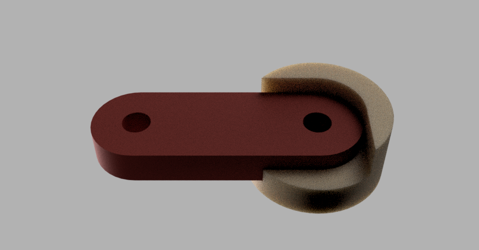

I think a SCARA arm like HELIOS would be a good fit since it doesn’t need a big frame to print big. However, my lift idea will need a big frame (but it could be an expandable frame).
I attached a picture that represents my basic lift mechanism. The printer would have 6 of these tabs. A screw would run through the right and would lift the tab until it clears the indention and then it would swing out of the way. Run in reverse, the tab would rotate over the indention and then lower. 3 of these would be right handed and 3 of these would be left handed. This means all of them could use the same stepper. The left side of the tab is for a threaded foot that you can microadjust at the start of a print.
Printing would consist of …
  • printing on the top of 3 exposed towers
  • raise 3 tabs while lowering the other 3 tabs.
  • repeat
This would require a large frame and a crap ton of belts. If I use 2 z steppers, the extruder wouldn’t have to have a safe zone and the first layer would be easier.
What are your thoughts?

I thought about the rack and pinion. I went from that to three screws. I liked the screw better because they could be printed easier as a thin shell and still work. That said…to make either work…there is a lot of fiddling you would need to do to get the print to interface with the start pieces. The fiddly-ness and the need for the start pieces made me go to this 6 tower approach. The towers could be poorly registered in the X and Y and they would still work. For the screws, I would have to nail the X,Y, and rotation of the screws. For the rack and pinion, I would have similar issues.
All that said, do you have any ideas that would allow for an easy start and low amount of throw away material?
Side note: The towers can also be prints themselves. For instance, I could print 6 squirrels at .2mm for all the towers and 1 squirrel at .1mm in the middle.

The screws would be large diameter but thin walled. That said, your single big screw with a rotating printer appeals to me. My only gripe is the need for a starter piece and registering the printer to interface perfectly with that. However, doing registration on one big screw is easier than doing it for 3. However, however, this will hide the print from observers. I can add port holes but that would ultimately require more plastic to achieve the same strength.
Back to my tab idea, I can design the tabs to intersect the part on most of the layers and we can add support structures for the layers that don’t intersect the tabs. This could give us almost no waste. I have an idea for an accordion frame that would let you move the tabs in and out to work with a lot of different prints.
I’m still not picturing how your tab/screws thing works.

Here is an animation of how one tab would work. I would have 6. 3 would support the printer at any given time and the other 3 would be retracted so you could print where they are.
The belt could work. However, one of my goals is to have it fit in a backpack. I think we can keep all of the components in a 350x350x75 box.
A printer like this would have low acceleration values. In fact, acceleration could be a function of the z in firmware.
Nice animation. I could see that working very well (provided it’s made with smooth surfaces and kept clean, so it indexes to the exact same point every time).
