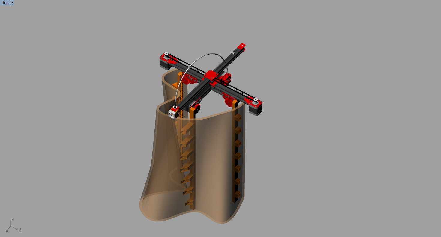

this are my thoughts put down just for clarification . the print starts with a preprinted frame and then it climbs up by printing a sacrificial rake. I don’t know how plausible this is.
Well, it won’t work as pictured, because the nozzle can’t reach the edges of the print, but that could be fixed by setting the pinions further out from the crossbeam. For balance reasons, I would probably also put the motors on the front side of the pinions, since the whole mechanism looks kinda back-heavy. Maybe even lose the bowden tube to get the extruder motor’s mass further forward as well.
I also don’t think the rectilinear supports connecting the racks to the outer surface will be stiff enough, especially considering that you are presumably planning to print them in vase mode. It’s also a lot of unnecessary bridging when a thin full-length connection would be easier. Using something like Scherk’s second surface might work even better, because the compound curvature should make a much stiffer structure while also being much more interesting to look at.
Of course, you’re still dependent on the stiffness of your outer shell to keep the spacing of the racks consistent. If it flexes under the weight of the printer, the racks will move apart, allowing the pinions to slip down and the nozzle to crash. You wouldn’t even have to jump a full tooth for this to be a showstopper. Adding flanges to the sides of the racks with wheels that wrap around to grip the rack should solve this problem.

thanks for your great feedback. Yes i will move the motors out of the way in the x axis… that was a bummer. Flipping the z motor direction and adding flanges is a great idea. I am not so sure of adding a direct extruder to balance the weight but a lightweight titan with a e3d super volcano might be a better approach. I am not looking at printing in vase mode, but printing 10-15 mm thick single surfaces . so the racks could be made to work with more arch like bridges.
