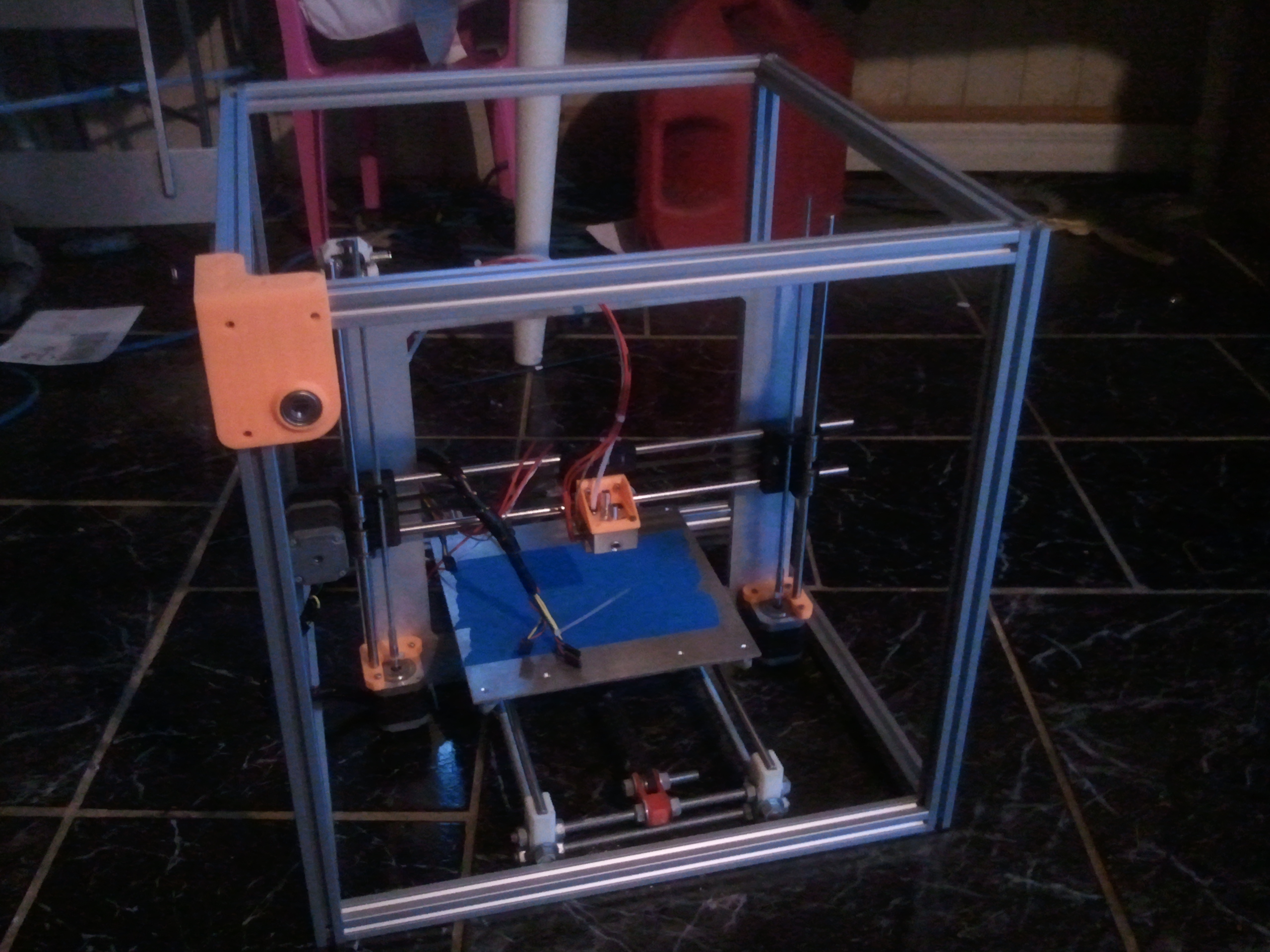

Ingentis/TST coming together.  Takes up about the same amount of desk space as my
Ingentis/TST coming together. Takes up about the same amount of desk space as my i3…but with a bigger build area and a better gantry design. The wall with the gears on it is work where I test/assemble/diagnose/upgrade DeltaMakers. Printed gears 2 layers high are a test we run on the machines now to ensure everything reaches the edges of the bed. Another shot included of my back room with the i3, DeltaMaker and new printer all in the same shot.
Awesome. Have you decided on xy ends yet?
Printing yours for now - already ordered the guitar tuners, so I’m going to try those as well.
I still can’t for the life of me quite understand how the spectra is supposed to work, but I’m sure I’ll figure it out when I get to it.
Also @Tim_Rastall , what hardware is used on your XY ends, just some 3mm socket heads?
NICE…Just the motivation I needed to get back to work on mine. I’ll be stopping by ACE tonight to pick up a 5mm tap.

@ThantiK you’re using the new ‘no bobbin’ ones? Each one needs a m5 x 20 bolt, nut and washer to catch the spectra, and an m3 X 15 bolt and nut to secure the 8mm shafts.
@Tim_Rastall I’ll use whatever ones you point me to! :smiley: – haven’t got to printing those YET. On the top corners right now so I can get the 10mm rod in place. Printing order ATM is Corners -> XY ends -> Carriage -> Feet -> Figure out what I want to do with Z axis
