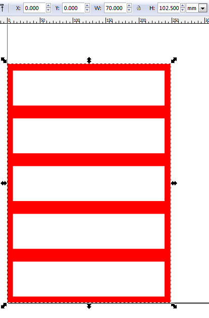

insert svg format (inkscape) to LW4, why the size different with original size?

Can you upload the file ?
even follow what http://cncpro.co wrote they, for svg dpi 96, still same result not actual size

I tried to open your file. It works with 90ppi which is related to the old inkscape version: Inkscape 0.91 and earlier used a value of 90 pixels per inch.
from Units In Inkscape - Inkscape Wiki
Update to a recent version to use 96dpi or set it at 90. #RTFM
@adam_ian no, for svg files. For bitmap i have 600 dpi or 300 dpi, depend of the file.
solved, update the Inkscape, set to ppi 90
