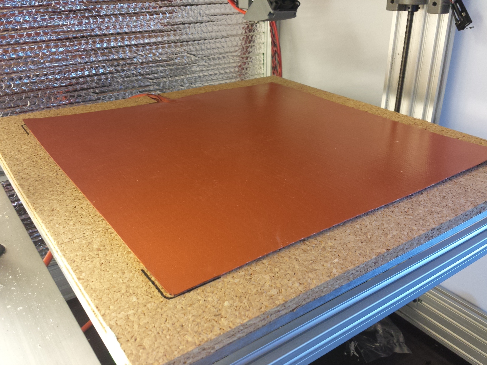

Installed my new 350mmX350mm 400 watt heated bed from alirubber on alibaba.
Installed my new 350mmX350mm 400 watt heated bed from alirubber on alibaba. They made it custom to my specs for $28.00 USD. Shipping was pricey but it arrived less than 1 week from when I ordered it. I ordered a 350 watt also just in case my power supply didn’t like that much power. But it works like a dream. Anyone in the midwest want a 350watt bed?
This thing kicks the snot out of the 300x300 QU-BD bed that I fought for months.
Oh I also learned 3/8" thick mirror glass doesn’t like 120C :slight_smile: at a 3min heatup cycle. I will be getting Borosilicate soon. But I am using window glass now until I can find a sub $100 plate at my 16"x16" dimensions. Any suggestions from the group on a source?
