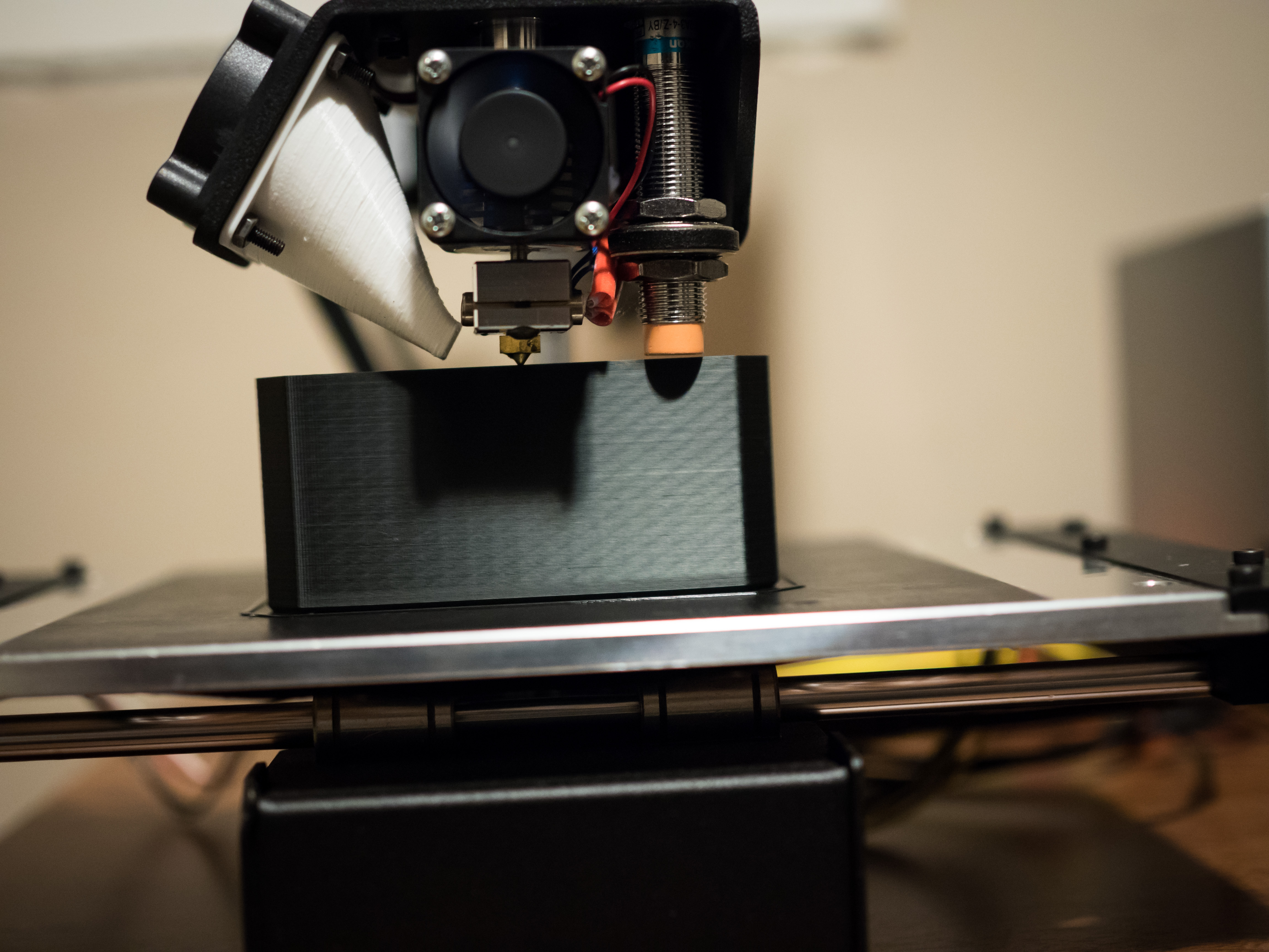

Installed the E3D v6 hotend on my Simple Metal this weekend.
Installed the E3D v6 hotend on my Simple Metal this weekend. Incredible print quality!

Is this PLA onto a BuildTak-covered cold bed? Were you unable to achieve similar quality with the original UBIS hotend?
I use E3D V6, additional area fan and Simplify3D for slicing from summer/autumn. Printrbot Simple Metal has grown several levels up in printing quality with it. (Added also own modified firmware and official X-axis upgrade with heated bed and BuildTak etc.)
Cool! Number of vertical shells is 2?

@Neil_Darlow PLA, BuildTak, Heated bed (60C). Works wonders. Zero warping. The raised edge around the bottom is a 45 degree chamfer. The original UBIS worked great, but not quite as smooth as what you see in the image. The E3D seems to control the filament flow a bit better.
@Tomas_Vit I also use S3D. Love it! This little machine definitely keeps surprising me… in a good way.
@Ivan_Hoe Yes. 2 shells.
Thank you @Andrew_Bougie , enjoy your printing journey : )
@Sonny_Lowe It’s the stock Printrbot extruder. I used this Thingiverse adapter: http://www.thingiverse.com/thing:559657
It’s not 100% plug and play, but it was an easy install. Did not have to modify the extruder for mounting, just used the above adapter.
Also printed this great fan shroud: http://www.thingiverse.com/thing:367602

@Scottie_D369 It heats up really quickly! The model is a small parts bin I’ll share on Thingiverse and other free model sites once I know everything prints correctly.
