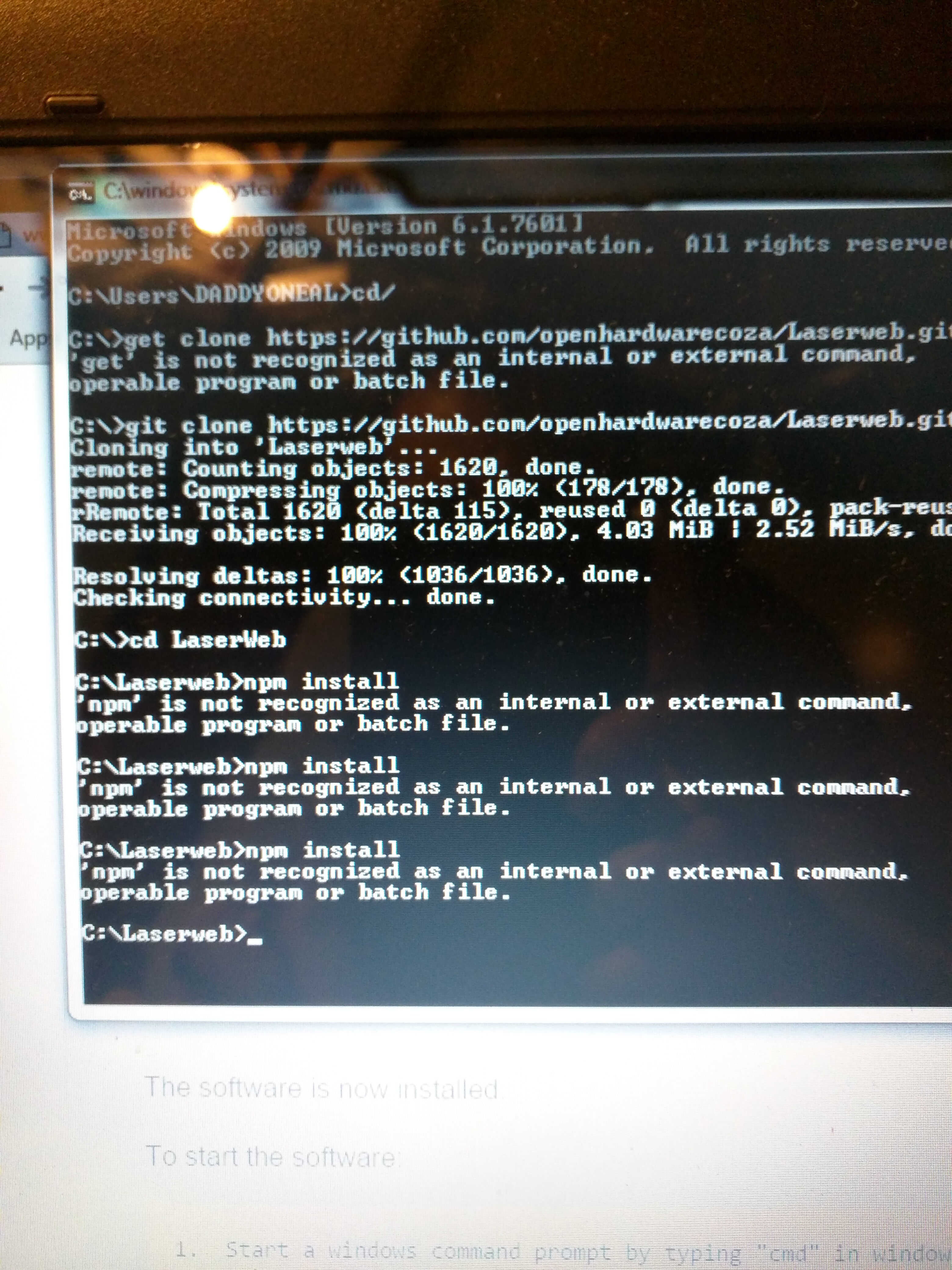

Installing laser web on win 7 laptop and all went well until this point
Installing laser web on win 7 laptop and all went well until this point npm install. As seen in pic when typed in cmd as suggested it gives an error npm not recognized as an internal or external command, operable program or batch. Any help would be awesome and thank you in advance for any assistance.
npm is part of Node.js, did you install that first?
Yes
Will reinstalling node.js, hurt anything or do I have start over?
Checked install on node.js and found that it do not install correctly, thank you for the help. I’m going to start over with install process now.
