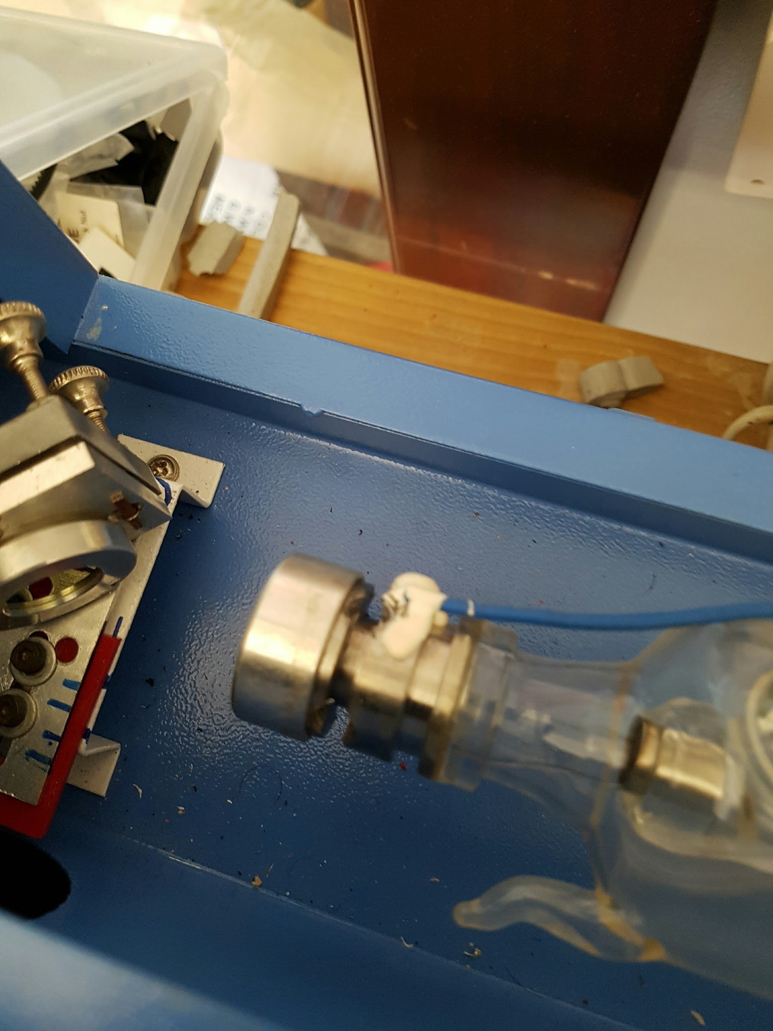

@Ariel_Yahni_UniKpty yah pull out your metal laser cap rotation tool and adjust.
I would let the suplyer replace the tube! They seem to have serious quality problems.

Well this guy keeps telling me to rotate that cap
@Ariel_Yahni_UniKpty whats the down side to trying it. Not working anyway. Make sure that that end is really gnd. I would even disconnect from meter and connect gnd directly.
@Ariel_Yahni_UniKpty did you manage to get it to work again?i have given up on it and ordered a nee tube
omg that video from the mfg… I’m guessing they don’t do workmans comp/insurance plans at that factory lol…
So you’re getting Co2 excitment inside the tube indicated by the visible purple beam, but nothing for laser output? Sounds quite similar to my current nightmare I’ve been dealing with… https://youtu.be/gVpyHNwwy3o
@Madyn3D_CNC_LLC Factory says the i only need to rotate the cap, but the screws are so tight im having trouble
@Ariel_Yahni_UniKpty Ahh, yea judging by the video they sent you, I can see in the background they sure like using their lock-tite!
@Ariel_Yahni_UniKpty if you haven’t already try:

@donkjr my outputlens is glued on and i wonder how to remove it. I tried scrapping the glue away with razor blade but it is still stuck on. Any suggestions?
@Paul_de_Groot we are going were no man has gone before
@Paul_de_Groot does yours have screws or just a metal ring that is glued? I think the permanent ones are put on with epoxy :(.
@donkjr just a copper ring. I don’t think its possible to remove it. It’s just that I’m in such a time pressure to complete things. I’ve ordered a new tube anyway with expedited delivery but still slow from china sigh
@Ariel_Yahni_UniKpty yes it feels like a crazy adventure. If i wasn’t such in a rush i would just wait for the new tube to arrive.
@Paul_de_Groot UGGH!
@donkjr yes i should be just patient, throw away the old tube and wait for the new one, sigh
