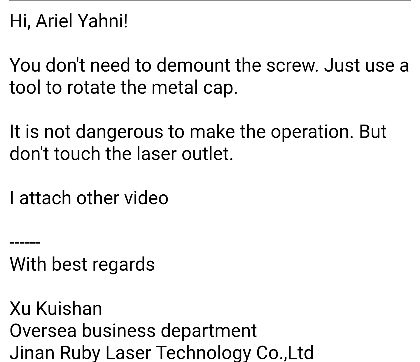

Interesting development. I received today this video from the manufacturer sent by the engineer regarding my tube issue. It seems like its focusing the lens on the tube?
Doesn’t it look a little terrifying???
Still i dont know what to do

@Ariel_Yahni_UniKpty if your research is done I would start adjusting the screws a small amount keeping careful track of how much you turn them. Maybe put a dot on the screw with “white out” to show location.
I would turn each screw in a sequence around the circumference followed by a pulse of laser to a target. If that adjustment does not work put the screw back in the original position and go to the next screw.
If nothing works going from screw to screw in one sequence reverse the sequence and try again.
Looking at their test setup I am guessing that there isn’t much precision needed.
Another option is to turn laser on continuous @ low power and tweak screws one at a time watching target. Careful of cooling!
I’m waiting until tomorrow and see if a get a explanation from this manufacturer as what exactly they are doing.
@donkjr thanks for the test process
