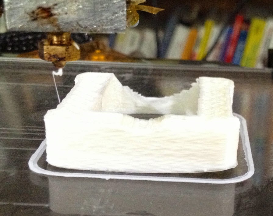

Interesting new problem today with the front right corner of my print lifting.
What’s strange is that it does not matter how I orient the part or where on the bed it I print it.
Printing ABS 230c, bed 115c.
Bed is clean, with hairspray applied (which usually works extremely well for me.)
Bed is level to .00 mm in any direction - measured with indicator.
Any ideas?

UPDATE: I wanted to test the above recommendations (thanks for your responses). I left temp settings at 230 hot end and 120 bed for ABS (no temp change after first layer.) I covered the air vent in the room, closed the door, put a sheet over back of machine and made a windshield on 3 sides with a file folder. I then reprinted the part with the same gcode as before.
RESULT: The part printed with almost no lift at the corner. There was a small amount of lift, perhaps enough for the edge of a razor blade.
