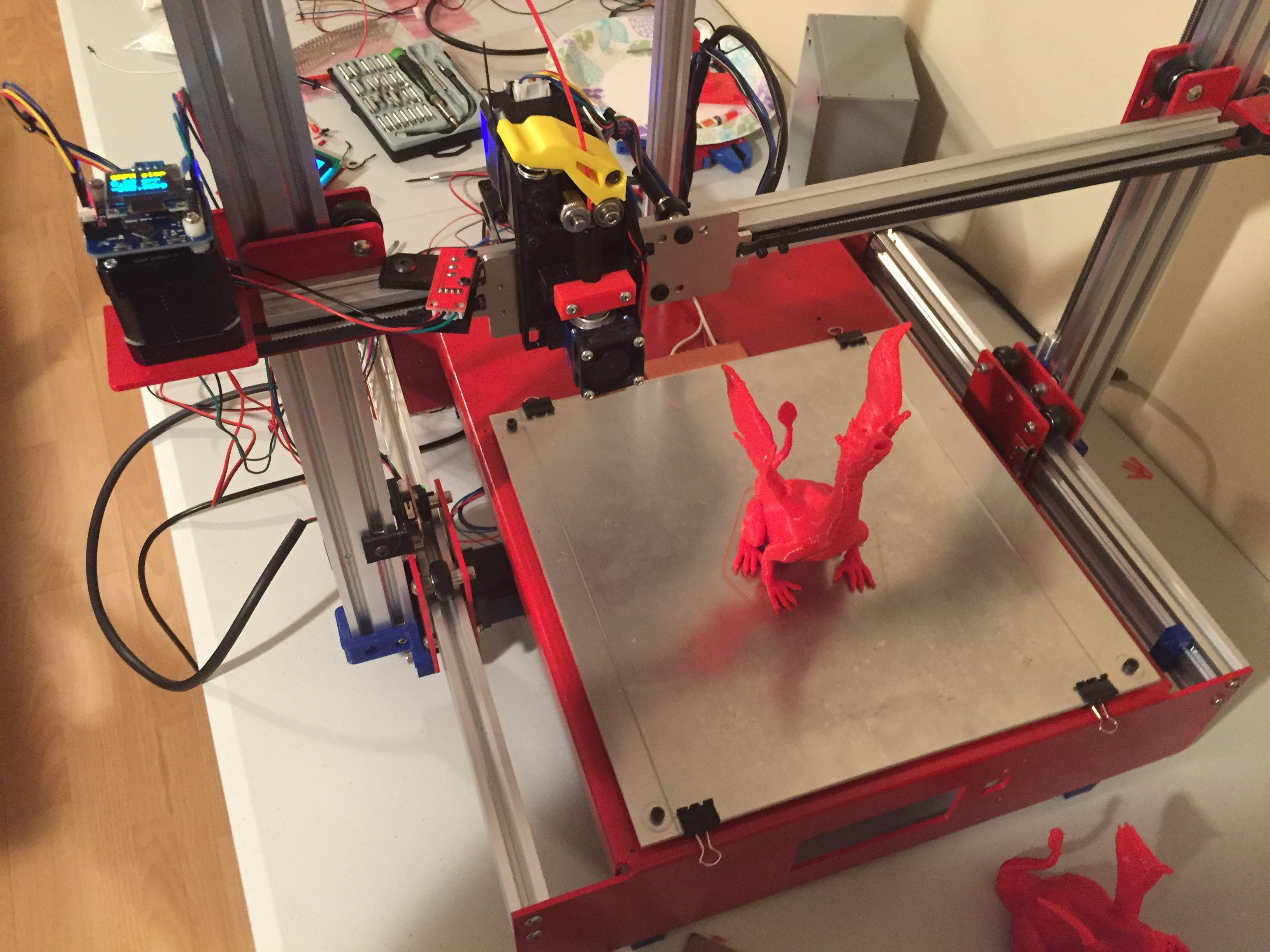

@Paul_Frederick this is the machine in question. The volcano nozzle was catching on the extruded plastic which was severely warping upwards. The “Smart Stepper” encoders on the X and Y axes have helped mitigate what were repeated catastrophic failures.
I have a bondtech arriving tomorrow which will hopefully solve my extrusion woes on this machine.
@raykholo
so what voltage are you running your steppers at, and what kind of drives do you have?
12 volts
that’s an atx psu in the corner of the shot. I’m making the move to 24v on all my new builds, but all my E3D’s are still 12v and I have a bunch of atx’s around.
Originally it was DRV8825 drivers with a lot of cooling (but also tried A4988’s with the same outcome) and the nozzle would snag within the first few layers and the printer would end up grinding away in the corner 15 minutes in. Repeatedly.
