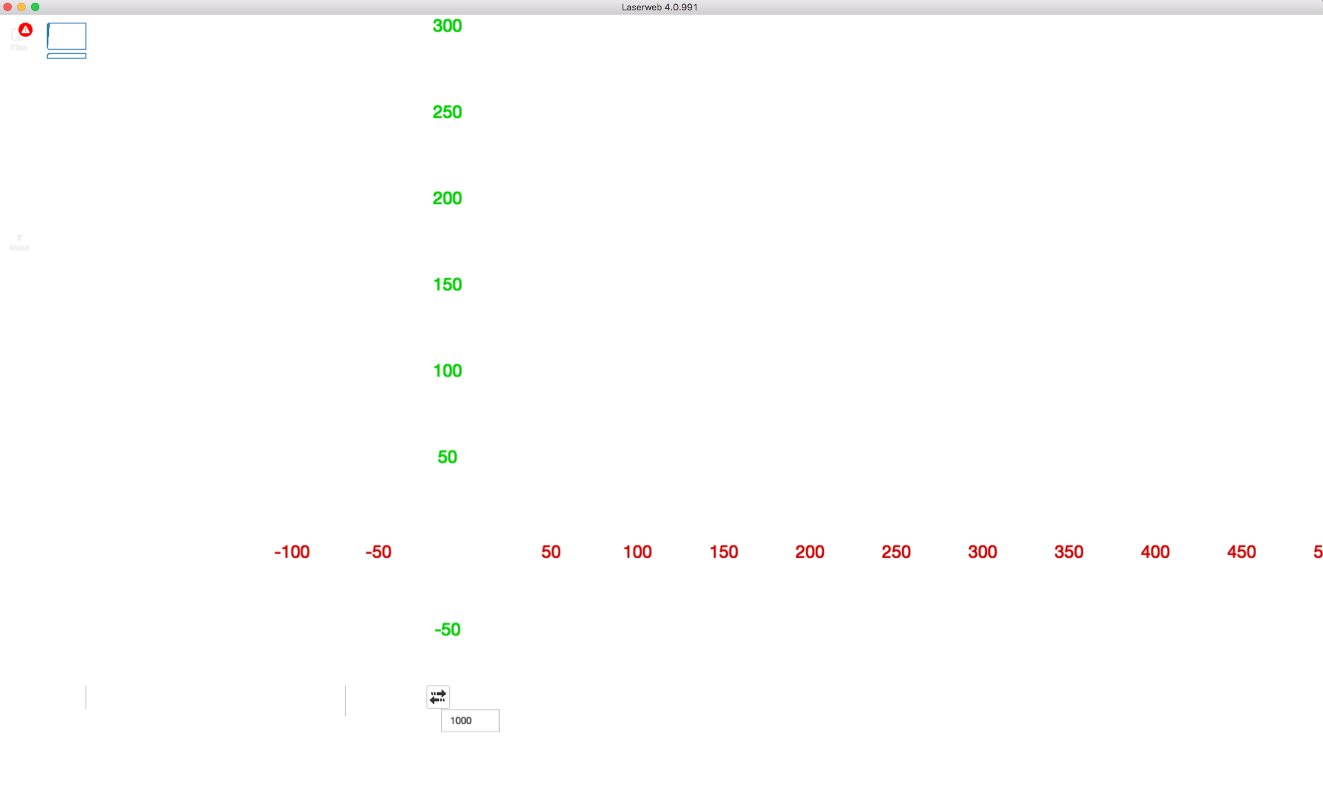

Is anyone having trouble getting LW4 to run on a Mac OSX 10.11.6? Here’s what I see.
Laserweb is 4.0.127
Laserweb is 4.0.127
This issue has arised before. Check for hardware acceleration settings. webgl needed.
Mine is running on 10.12.4 without issues.
Ok. thanks. I think my mac supports it but for now I’m running it through node.
If you use a laptop probably have the energy manager capping your gpu. Official browser is chrome FYI
