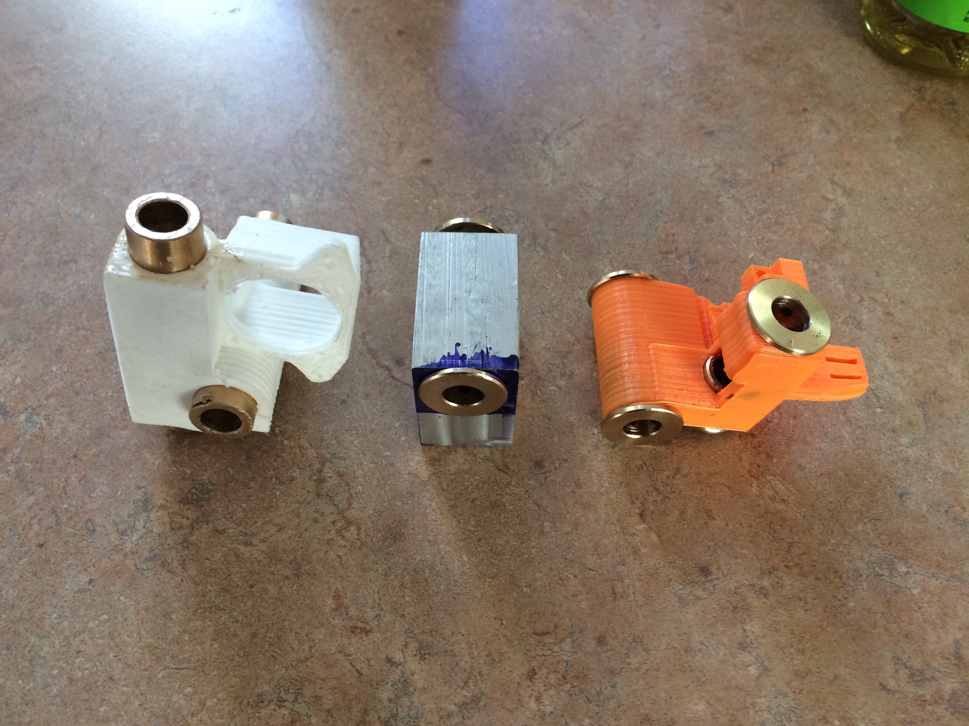

Is it a big deal that I’ve found the secret for smooth running carriages (hint, cram the bushings home, use a $4 reamer to re-establish a 10 mm path through the carriage).
Is it worth writing up? Because it’s been a problem that’s plagued me for years, and now it’s a non-issue. Works for IGUS as well as bronze…I don’t want to spend 10 minutes of your time with a 20 second solution…Youtube is full of that.
