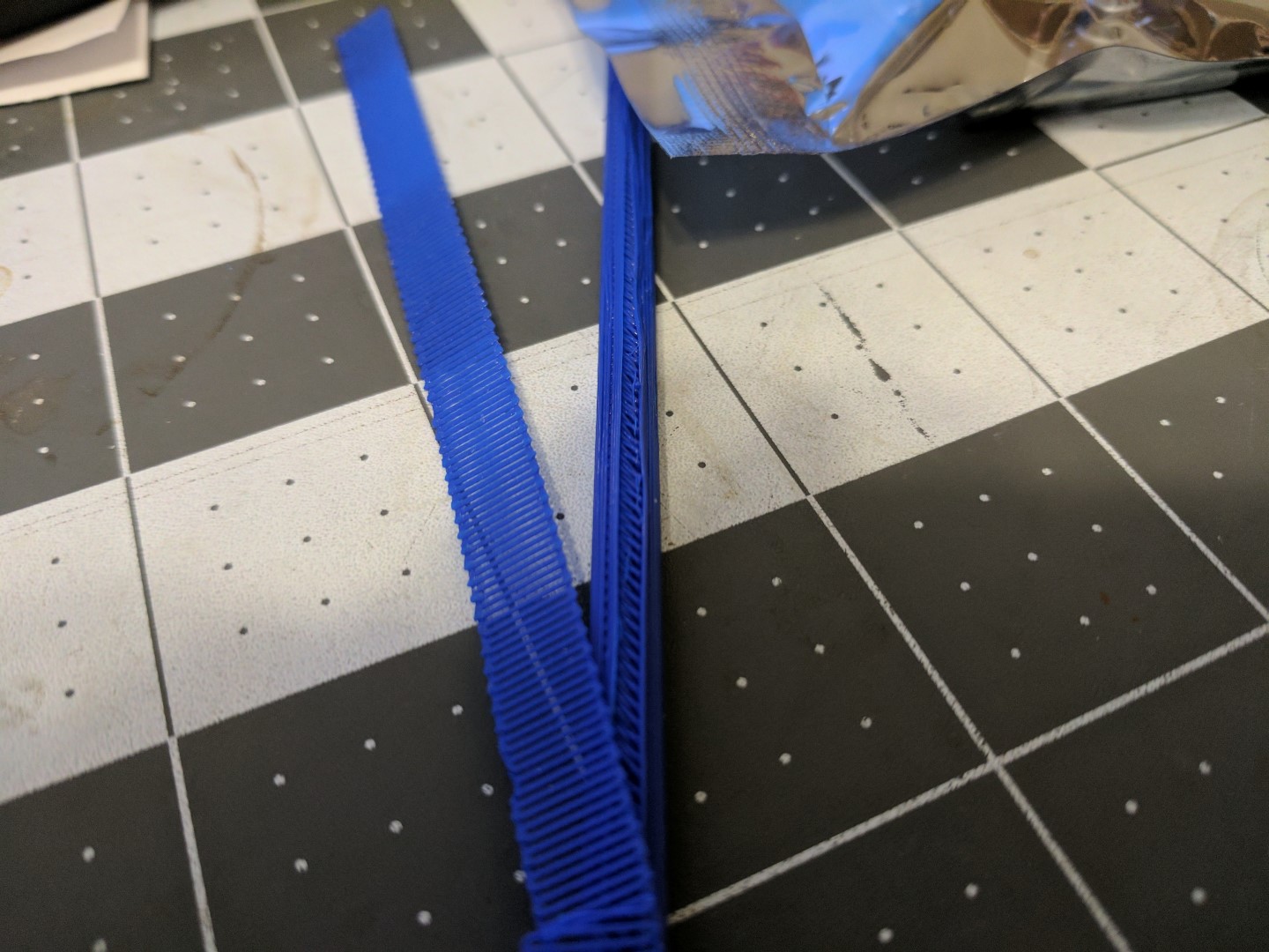

This is the quality I’m getting off my printer using Cura as the slicer. There is a close up of the supported surface in the album.
https://plus.google.com/u/0/photos/113930448883604105560/album/6279572825981682993/6279572921108202834?sqid=117996416225488251038&ssid=dcc70643-9984-4384-99c9-674504053111
@Jeff_Parish Wow, those look good. I’ve run the support density at 90% before and still didnt get the same result. I’m not sure it’s a cooling fan issue since the layers do not seem to be connected for the first 2 or so. That’s why I’m leaning on settings. What were yours for those results? And what version of cura?
@Michael_Boquist Thank you. If I do not use a good part cooling system the supported surface is all bumpy and droopy between the supports. Generally my support density ranges from 15 - 30%. Depends on the geometry I’m supporting. The samples in the album I believe are 20 or 30? The only time I have gone higher is with soluble support. Using Cura version 15.2.1. XY offset distance are defaults. Z is set to .1. Overhang angle is set to 60 and layer thickness on the print is 0.1mm most of the time. Print speed is 40 mm/sec.
