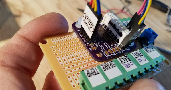

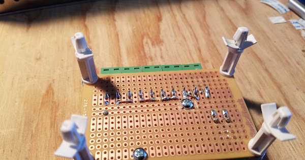

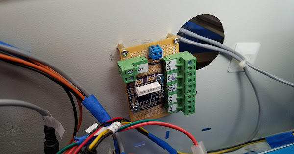

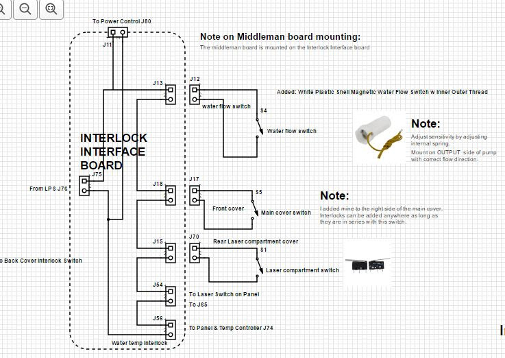

BTW I found that an easy way to wire interlocks it to bring them to a breakout board which is then connected to the LPS laser switch loop.
The schematic and picture below shows how.
This board through J75 connects to the LPS laser switch loop.
J11 goes to a led/resistor on the front panel telling you if any interlocks are open.
Then you have simple two-wire assy’s that come from each interlock switch to the breakout which uses screw terminals.
You can ignore the middleman board I mounted it there for convenience.

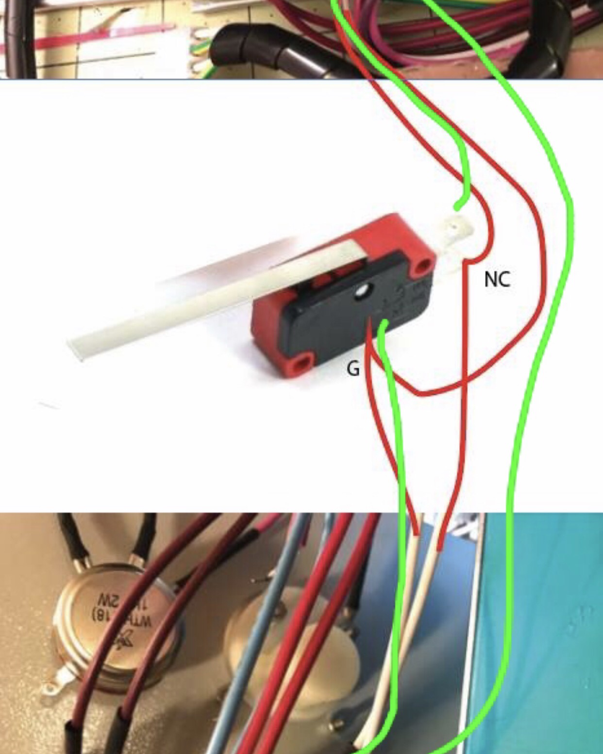

@donkjr is there any reason not to do
Something like this? Ignore the hand drawn red wire. The drawn green wire is what I had been advised. It would be wired into the laser switch.
Any configure where the switches are all in series with each other and the laser switch works.
Its hard for me to tell from the picture but that looks overly complex.
You want it wired so that when the lid is closed the switch is shorted.
