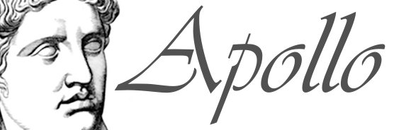

Here is an example of what I’m trying to burn. Currently I’m testing with lighter text color to try to prevent the burn through at 100%. This exact version is untested, but the face has been tried already with no luck.
