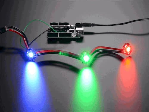

Is it possible to use these Pixie LEDs with FastLED?
Is it possible to use these Pixie LEDs with FastLED? What type of LED do I put in the FastLED.addLeds<> call?
they seem to use a different protocol : Originally, they have designed the Pixie to support the same serial protocol as the WS28x family. However, this compatibility, which was originally considered a feature has been eventually deemed a drawback.
Yes, the Pixies use a different protocol. A very simple serial one at 115200 bps though. I think anyone with a decent familiarity with FastLED architecture could create a Pixie CLEDController (maybe cribbing from the DMX controller already in FastLED)
If you just want the color control that FastLED offers, then you can use it to manipulate RGB values before sending them serially, but it doesn’t use a standard (for FastLED) protocol to communicate.

Thanks - in ordinary FastLED? What’s the CHIPSET declaration? These are B R I G H T !!! I made the mistake of looking at it face on when running the Adafruit demo. I couldn’t see for a few minutes! :slight_smile: I also wish I could solder better…
PIXIE and you have to include SoftwareSerial.h before you include FastLED.h
@Mark_Ortiz I Felt that way too. These things are hard to solder!
