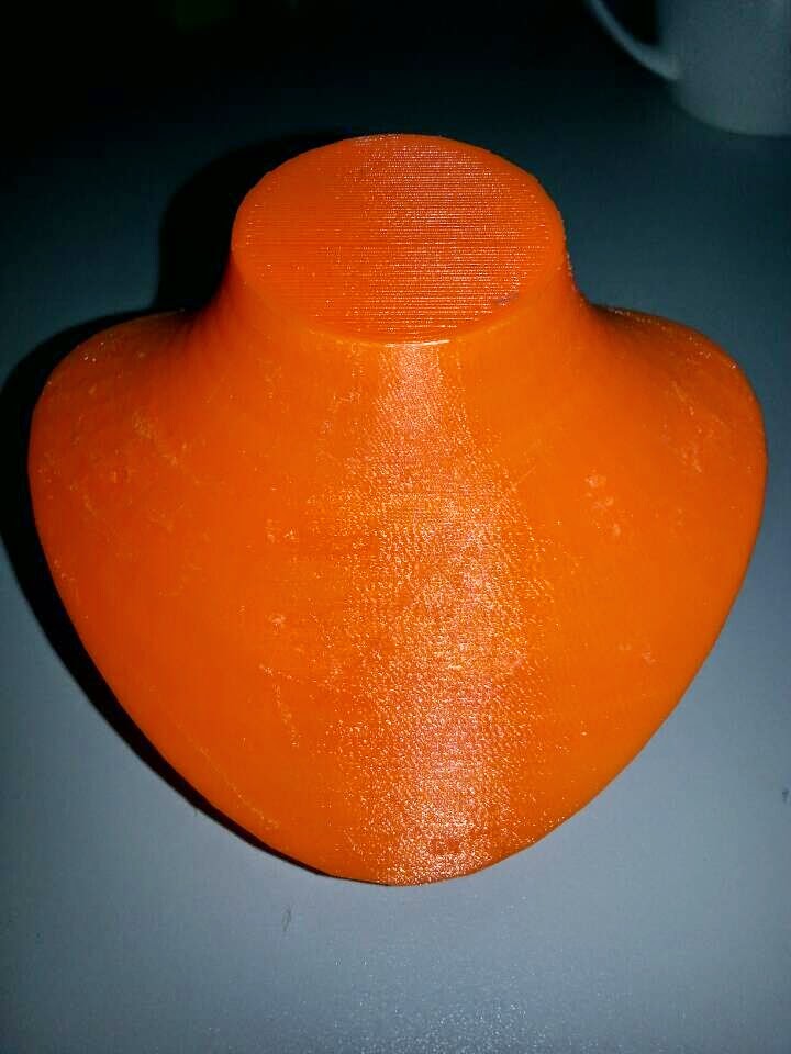

3d printed?
@Multicopter_Maniacs yes…
I’m curious about the bumps that are showing up. I’ve seen that on occasion and had read that sometimes it might be due to moisture in the filament.
@Tim_Sills keep the filament under the vacuum state and don’t use the filament which contact with the air for a long time
At least some of the bumps are probably the lead-ins and lead-outs (or starts and stops) of a given layer. It is worth trying other software or other settings to see what minimizes it.
