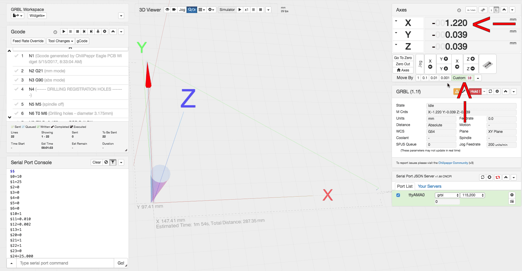

Is jpadie still the best branch to use for GRBL http://chilipeppr.com/jpadie? Was working fine a couple weeks ago, but now I am getting an incorrect reading on the axes. I’m trying to move 10mm and the axes are only showing a movement of ~0.4mm. The movement is correct on my CNC machine, but not in the Chilipeppr UI. Dragging in a new Eagle board seemed to cause some weirdness as well. I tried to empty cache and hard-reload but that didn’t seem to help. Is this a known issue?

I can see in your video now. Your board is set to report in inches ($13=1) but your gcode is in mm. If you push a G21 and $G to the serial port manually you should see CP forcing the board to report in mm.

Thanks a bunch for your help. I set $13 to 0 and that worked for me. I’m not sure how it got set to 1. Haven’t touched my CNC in a few weeks and the last time I used it I was on jpadie and everything worked great. I think the Eagle board import problem was a user error on my part. Sorry for the confusion there.
