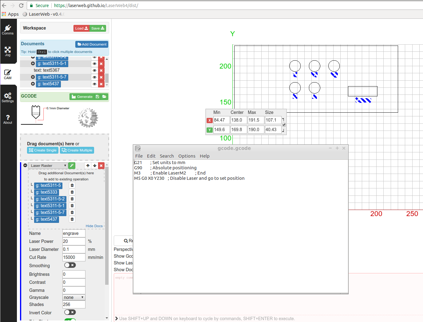

Is LW4 Laser Raster not working at the moment? I have an svg with some text sections. I did object to path and loaded the svg in LW4. I can pull out the text paths and setup all of the CAM options, but when I generate the gcode I just get the header and no raster information.
Laser cut shows the paths fine.
Is this an svg with a raster inside?
Raster handles images. Fill Paths handles paths.
Duh. I knew that but had a brain fart. Sorry.
Yup, raster is working just fine and so is Laser Fill :slight_smile: I’m learning that I really have to slow down laser fill to keep the machine from practically jumping off the bench when doing small text.
