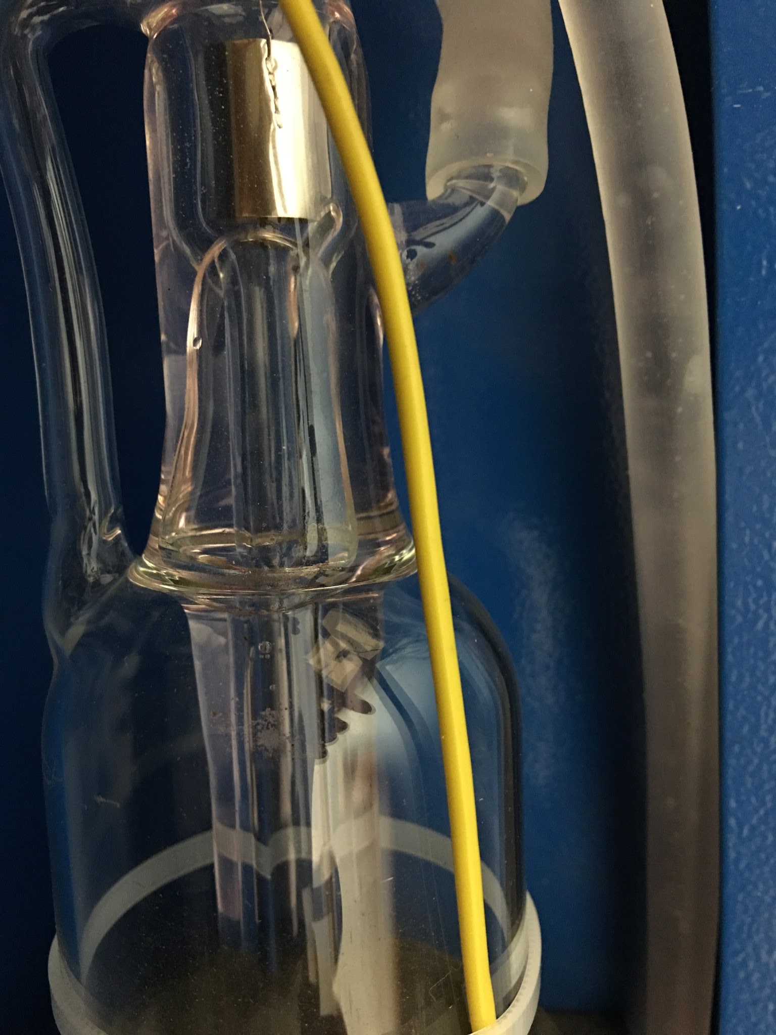

Is that air bubble ok and if not how do I get rid of
Is that air bubble ok and if not how do I get rid of it
Those bubbles dissapear with the flow itself…
Is the machine level and more importantly is the laser level? I had and still get bubbles like this on the exit end. I would have to lift laser on outlet side then maneuver until all bubbles passed, if necessary turn off water pump letting water recess about mid way then restart pump then repeat as necessary. To aid in this issue I now use a heavy duty mail clip to kink the outlet hose until next use. After clipping water line I power down, there are more solutions to solve this in a way that is electronic in nature.
As Andrew said try raising the machine on an angle to help the air escape. My water tubing sits submerged in my tank, so air is never reintroduced.
Lol never took that into consideration man. Lmao, just when I think I thought of every angle, I happen to learn more. Awesome, love this community and all the knowledge within. Note, extend outlet hose to submerge.
Just make sure water tank is at same level as laser cutter that wAy water does not drain out when pump is off,i like to see water going into ta k from laser tube to check flow rates,i also have a water flow switch on the pump that does not alow the laser to fire with out water flowing

Air bubble danger is if the metal ring isn’t cooled properly, with metal expansion, it will crack the tube. a small bubble not touching the metal ring could be ok.
It’s so not worth it, considering how easy it is to get all the air out!
Corey just search this forum for the amount of people that have screwed their tube because of air or heat!
