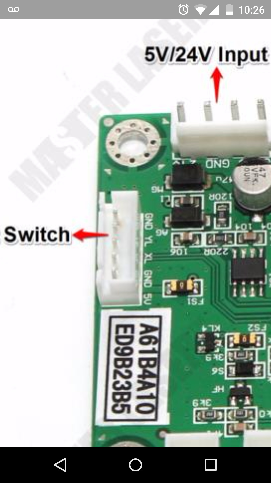

Is the connector labeled switch a standard molex connector?
Is the connector labeled switch a standard molex connector? I’m going to buy the female socket to create a harness for the limit switches to connect to smoothie in case I ever want to revert back to the stock board

+Peter van der Walt​ just checked the stock connector only the middle three pins are used I will need to run a continuity test to see if they are NO or NC limits
No need for a meter contacts for limit switch are visible and are NC contacts
The connector labeled Switch is a JST connector. I see many of them advertised with and without wires attached on e-Bay. JST makes a number of different size connectors that look a lot alike. Measure the pin to pin centers to determine the correct pitch.
really looks like a JST PH serie to me
