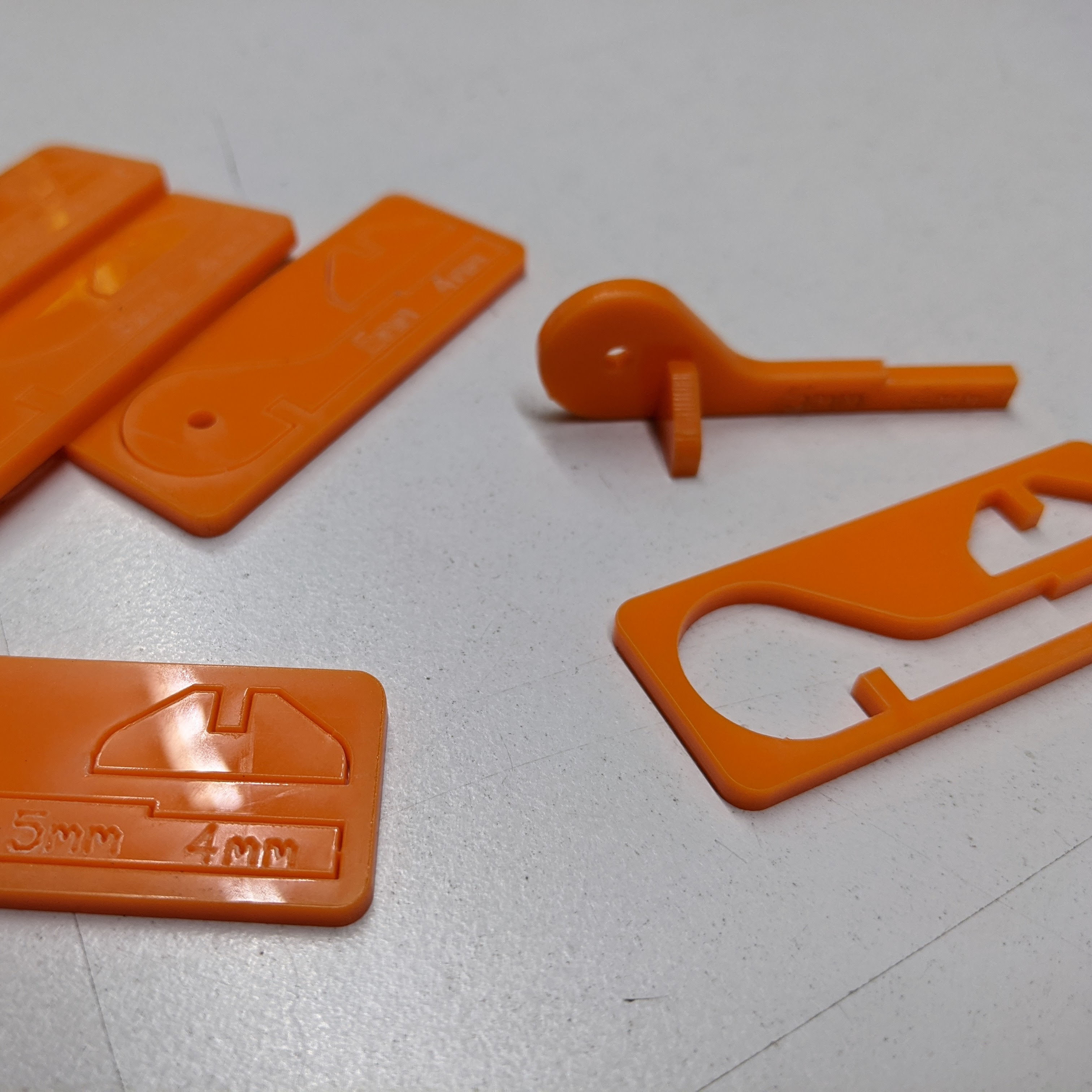

Skip the autofocus option. We have a Thunderlaser machine and this function passed away approx 3 years after buying. Since then we use the machine without and we have not missed it. :wink:
We adjust the space between the laserhead and the workpiece with a mechanical gauge.
The clearance should be between 4 to 5mm. So the tip of the gauge should fit under the head.
