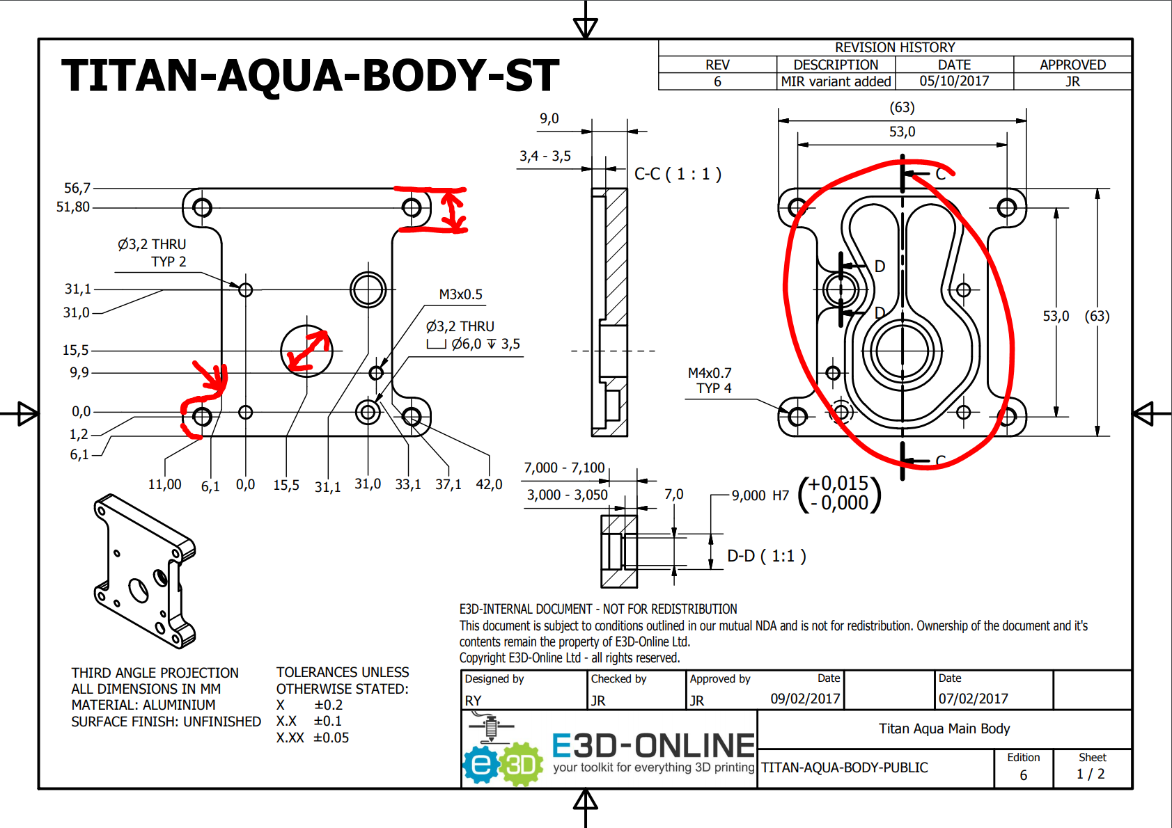

Well, E3D is releasing schematics, with 95% of the needed measurements. And keeps random 5% a secret. Not sure what to think about this. IMHO, they should release a simplified but COMPLETE drawing , not this “we leave some random measurements out to make the copycats a fool”.

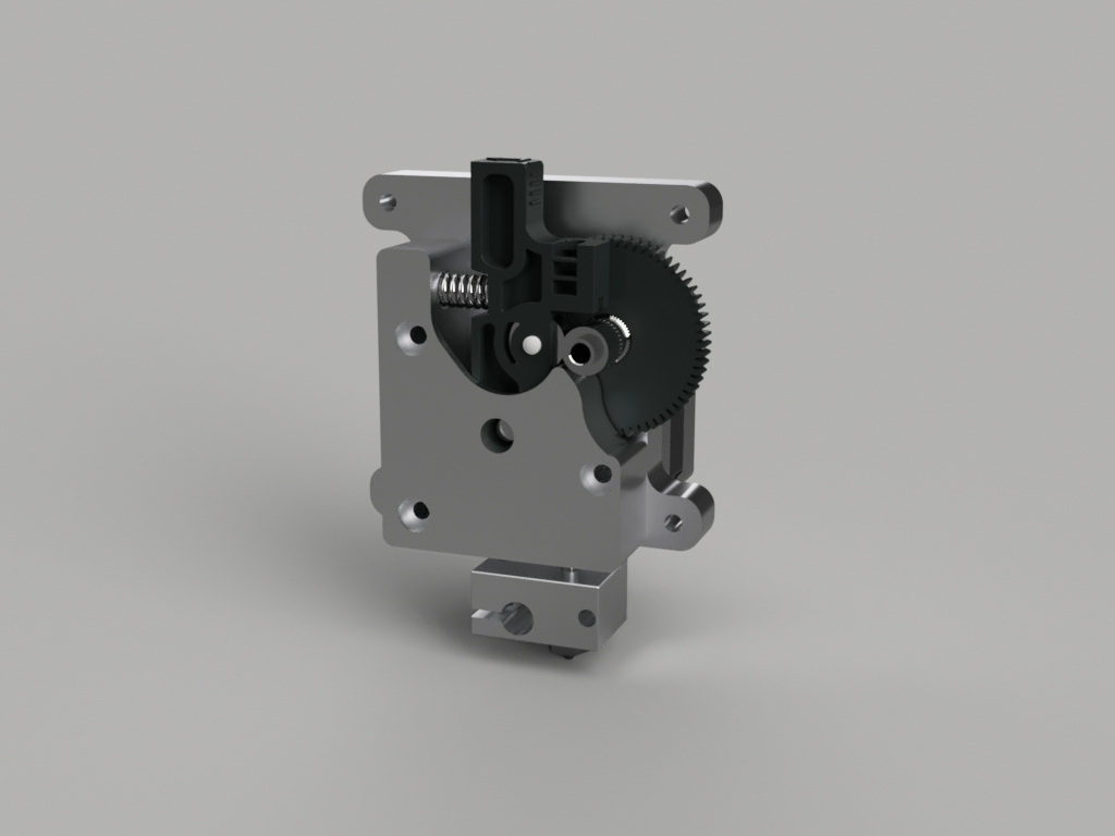

CAD took me an hour and is accurate where it matters. The rest was guessed.

@Tim_Elmore Look what I marked red. And that is just page 1 of several drawings. While I don’t need that internal water-channel for mounting, I could really need the complete outer dimensions/radia. Don’t get me wrong - I highly appreciate that there ARE drawings available! This is very nice!

I DO NOT assume that they INTENTIONALLY left out some measurements ^^ Why should they? They do publish nearly all of their stuff - great and very nice of them! But when publishing info as a drawing, it better be accurate, or? Especially, if you are one of the market-leaders.

@Rene_Jurack We try and make the main drawing the most useful drawing to the customer for mounting and use etc. Sorry we fell short of the mark here for your needs.
I’ve put a note in the with guy who made that drawing (Rory) and I’m sure he’ll appreciate your feedback.
Stuff isn’t left out to obfuscate, we just try and make the drawings the most useful engineering data possible. dimming every rad would be a more proper manufacturing drawing, but makes for a messy print that is hard to follow for most applications.
If you just ask we’re always happy to help/share.
Tagging in @Rory_Yonge to help out
