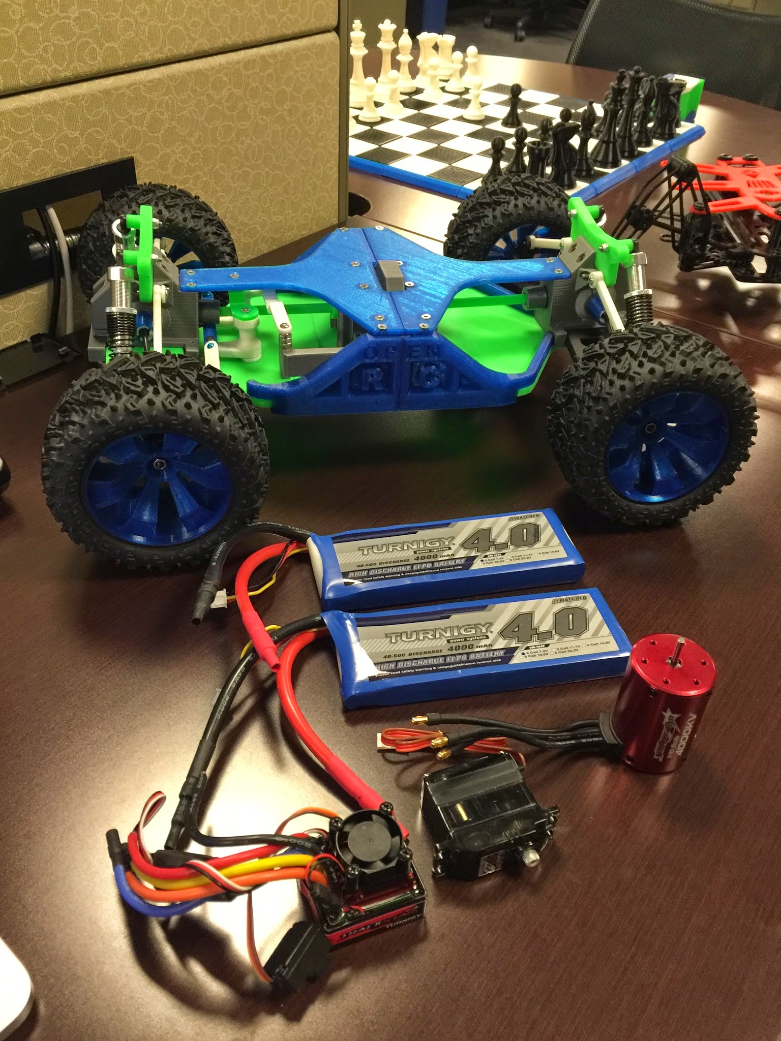

Is there a dummies guide on how to hook all this up?
Is there a dummies guide on how to hook all this up? I need help pairing the HK-GT2 to the Turnigy esc + motor & servo.
Okay! I figured out how to pair the two.
I must have missed the part where I need connectors from the battery to the motor. What are these called? I will go get them tomorrow at a local hobby shop.
Bullet connectors
No problem and I think they are 4.5mm bullet connectors

Do we know for sure if these are 4.5mm or 5.5mm bullet connectors? I’m going to order them on Amazon. They have 20 5.5m for $9.95.
I’ll check my hobbyking order when I get home and let you know for sure.
they are 5.5mm bullet connectors, sorry
