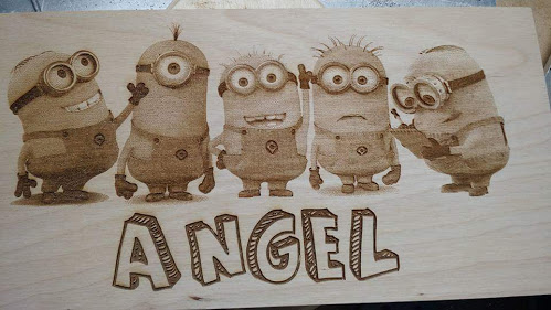

@Cody_McNary an example of dithered image you can do with stock controller
That took alot of practice tho so don’t get frustrated if you don’t get the results you want
