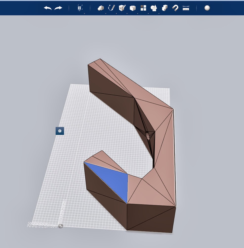

Is there a way to merge faces of a model in 123D Design software (not the online edition) to make the model solid? I successfully imported an STL file into 123D Design after converting it to STP format using InStep program. However these triangular faces I don’t know how to get rid of. In Sketchup it is possible by just selecting the line and deleting it… Here’s the snapshot of the model I want to round off the edges of, but can’t before I merge these faces…

I found your hook here: http://www.thingiverse.com/thing:194
I’m able to convert it to a valid solid, but I can’t get rid of the triangular faces where there are holes.
Normand, Tinkercad imports STL files without nasty triangular lines around the holes.
So does SketchUp. Yet that does not mean they are not there, they just don’t show. I believe both are mesh modelers (I’m sure in the case of Sketchup, not as much about Tinkercad since I don’t use it). In mesh modelers, you produce models made out of facets, not of mathematically precise surfaces like in CAD software. Mesh modelers can “smooth out” models and make those facets seem to disappear, but this is just a visual trick, inherently the model still retains facets.
