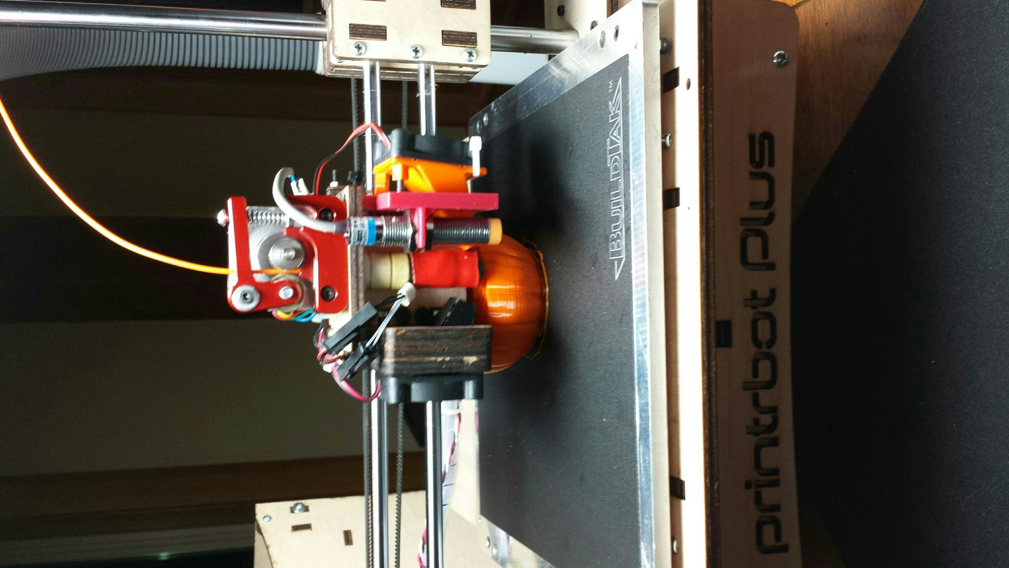

Is there a way to reverse the y axis while homing but going back to normal once the print starts? I’m sure there’s a gcode command but I’m not finding it. As you can see my punkin is backwards. Oh I’m also using cura. Thanks for the help, you think after almost a year I’d be able to do something as simple as change the electronic out.
You can change the Y_HOME_DIR in the firmware (Marlin) to -1 (min) or 1 (max), but you can’t do that from Gcode.
@John_Davis I tried that but the prints seems to be reversed.
@Gunnar_Meyers Ah, didn’t see the pictures first time around. If you’re using a pb+ with a probe and your Y axis is reversed then you’re probably using the wrong firmware. Printrbot’s documentation and organization of firmware leaves a lot to be desired and the funny things they had to do to get the “bed leveling” firmware working on the Metal Simple caused me no end of headaches when I tried to get “bed leveling” (I prefer “compensating”) working on my GO! v.1 as well. I did finally find a version I could get working, so I’ll Dropbox it for you and post a link (it’ll have my settings, but it’ll get you started).

@John_Davis In theory shouldn’t it work. I’m running the firmware for the new printrbot plus on the new rev. F board.
@Gunnar_Meyers Where did you get the firmware? (I don’t think I’d run the firmware I uploaded with a Rev. F board - I’m using a Rev. D board so no digi-pots.)
@John_Davis I got the board with firmware from printrbot and gave my Rev. d to my 11 year old brother for the printrbot Original were building him.
Maybe just try flipping your Y axis motor connector around.
