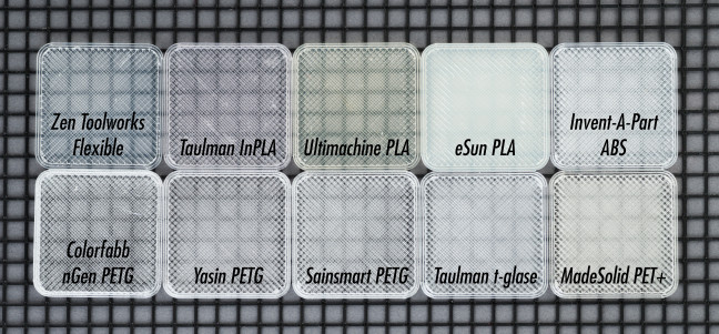

Hatchbox has a transparent white ABS. Also look at a review of transparent filaments at Thrinter by @Walter_Hsiao
