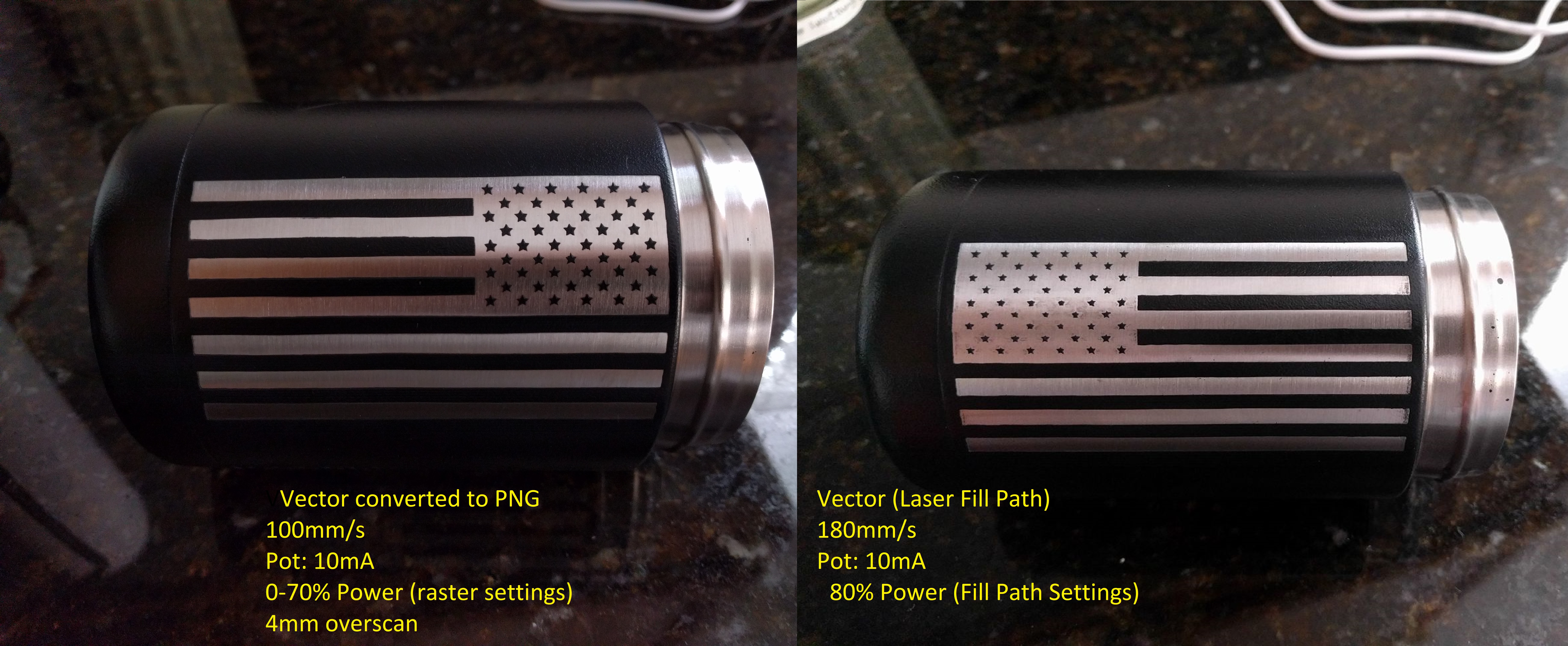

@Todd_Fleming Thanks for the bitmap suggestion. I gave it a shot and here is the result. You can really tell the difference in the stars
