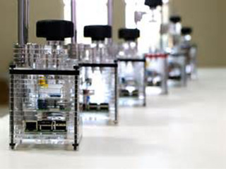

Is there anyone that have a IBOX  Resin printer like the one on the
Is there anyone that have a IBOX Resin printer like the one on the picture? I have one but i cant get it to work… Its like it all sticks to the glass surface no matter what i do. Im thinking that it might be better off in someone elses hands haha.

I’d be willing to play with it and look at it, but frankly from what I’ve seen, that’s what I’d expect to happen for anyone.

If you take it apart, I’d like to know any details on the screen they are using. Snap some pics if there are any part numbers on it…if you take it apart.
A mold release agent like polyvinyl alcohol may require several coats on the glass surface .
  1. Rough up the aluminum build plate with some sandpaper - don’t get too carried away.
  2. Make sure there is FEP tape in the vat (bottom) and make sure it is aligned with the display.
  3. You may want to try shielding the printer from any UV light sources.
Good luck, I have had limited success.
Avoid getting any resin or Isopropyl alcohol on the acrylic!!!
