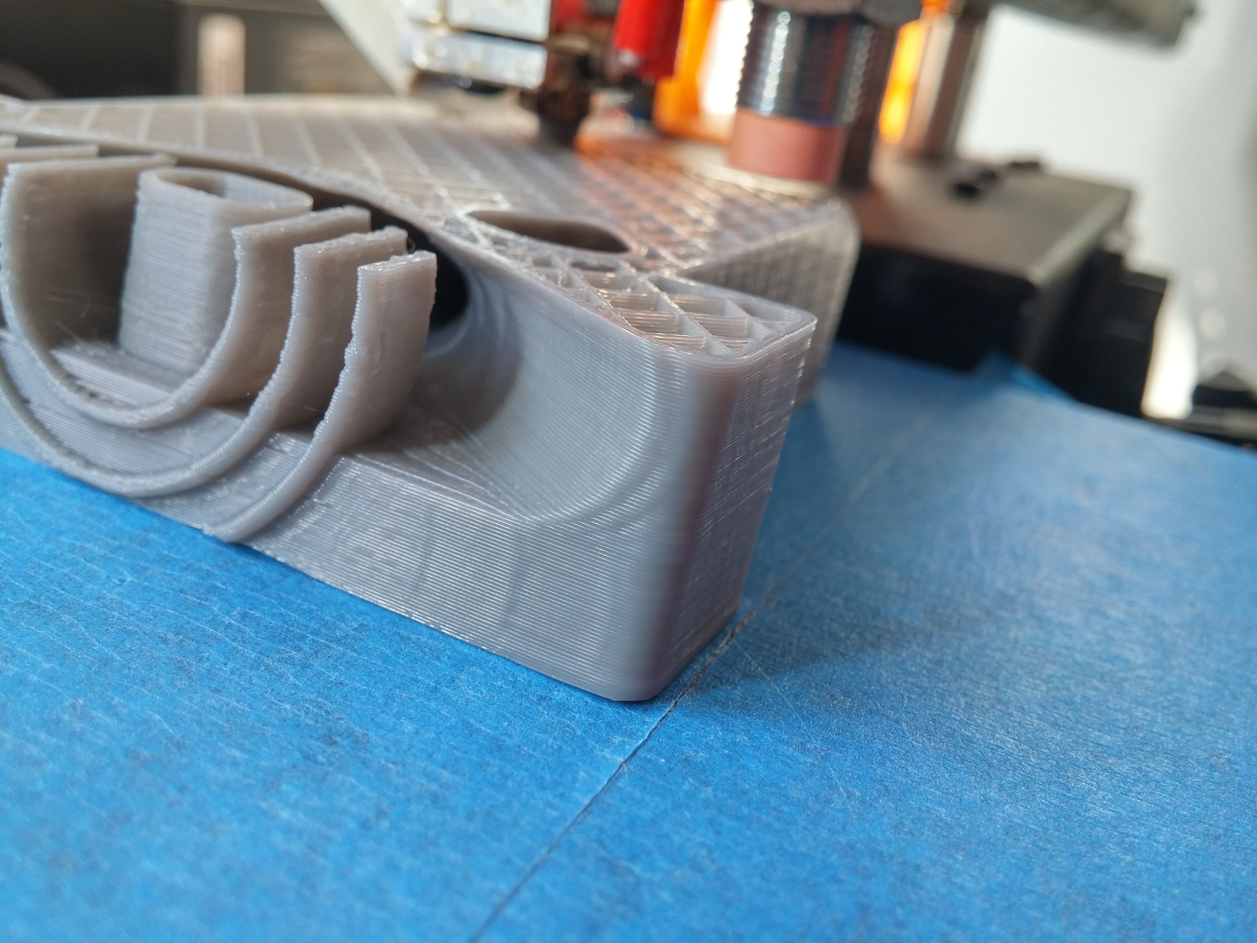

Is there anyway I can resume this print?
Is there anyway I can resume this print? My computer crashed and shut the printer down mid print, I really dont want to wait another 8 hrs for a print.

Measure with caliper the height of that print. And start a new slice and sink the z at the amount of what the caliper showed you. Then glue them together
MatterControl has a print resume feature. Won’t help with this print, but a lot easier to get setup than a pi. No hardware needed.
If you can figure out what Z height it is, you could copy the gcode file to a new file with the lines referring to the already printed Z heights removed. That is an alternative to the idea of removing from the print bed, measuring and slicing only the lines above the specific height.
