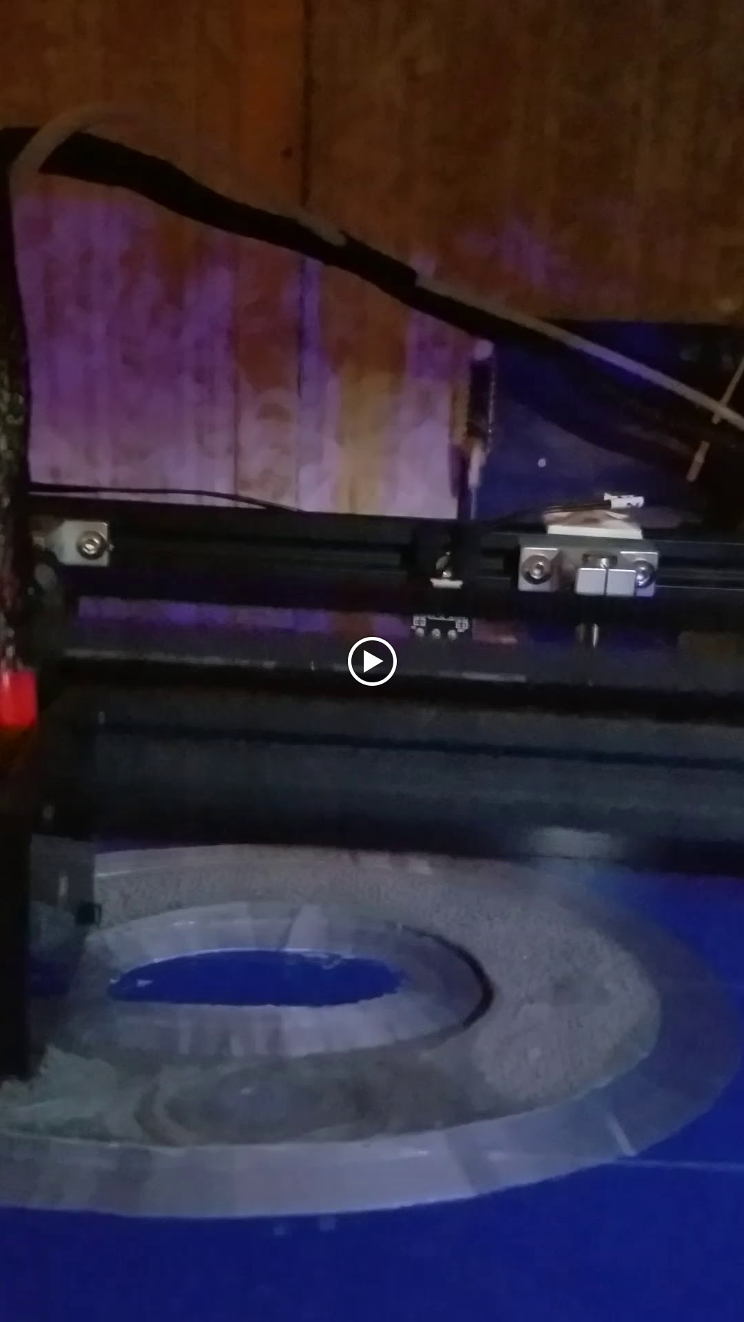

Is this a normal line infill pattern?
Holy smokes that infill pattern is tiny. But my guess is yes, looking at how that nozzle is moving.
i don’t see any infill in this video, sorry.
Z axis issue?

If you do not give enough information, then everybody gets wild guesses.
You will not be able to choose this as well as you do not know the cause of the mistake.
You do not write anything in the text (layer thickness, speed, slicing software, what is the initial fill in, how many fill percentages …)
The video is obscure and far away, the point does not look.
I call it everybody: Be precise if you ask! (for 3D printing this is still basic)
@Jakab_Gipsz I definitely agree… However I only kind of know what’s going on because I read his previous post, and this is an update to changes he’s made to his slicer settings, following some advice this group has given him.
But yes, a description (or a link to the previous post) would help give a complete narrative of the situation. :slight_smile:
Ok guys, just got home and pulled the printer apart. So how often do you change these cheep Chinese thermisters? Here’s the story, when I adjusted my infill settings, under the infill tab, I adjusted the shell thickness? Yea that was a stupid! Though the lace look of the skin was pretty cool, I decided to stop the print and do it right. This is a learning experience for me, I’ve been printing for a week. So as I was engaged in slicer settings,
Well I heard a noise that drew my attention, when I looked up, smoke, I yanked the plugs. Tonight I pulled it apart, the thermister appears to have shorted on the heat block. Hard to tell, the heat block actually got so hot, it distorted! Pretty impressive really, if I could give some advise, don’t use it as it comes? They over tightened the thermister screw. If I run this set up again, It’s getting fiber washers. Witch brings me to m
