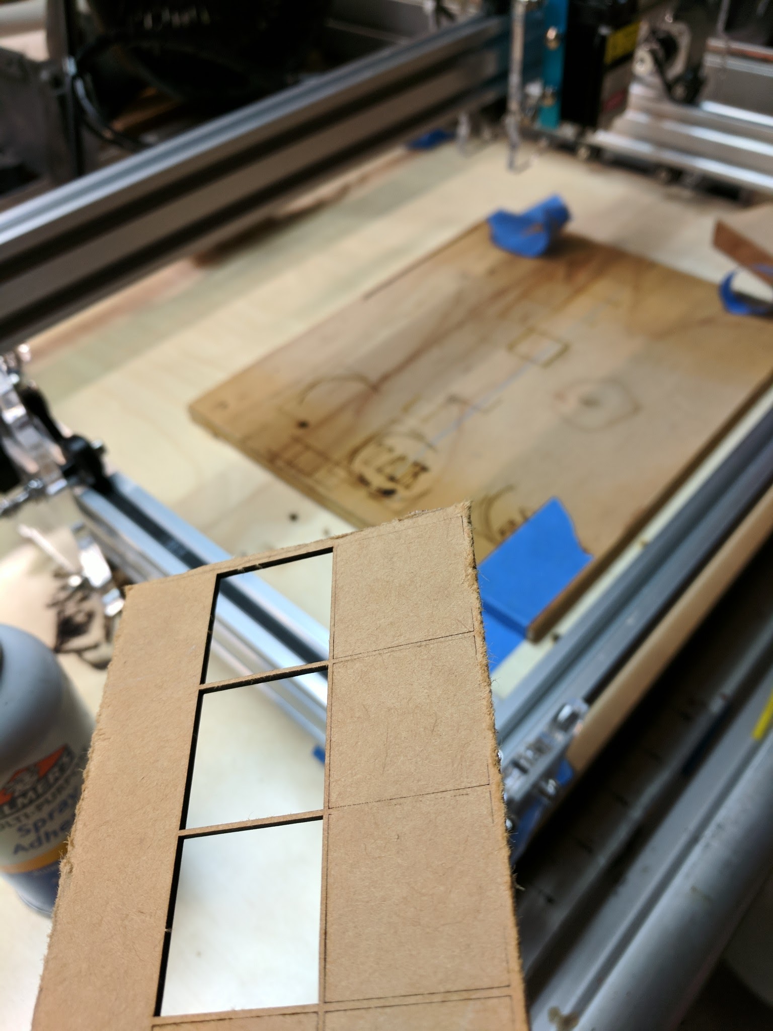

I have tight tollerances and accuracy now. For some reason LaserWeb4 doesn’t work in Mint 18.2, but does work in Ubuntu with a few bugs that I will try to figure out.
