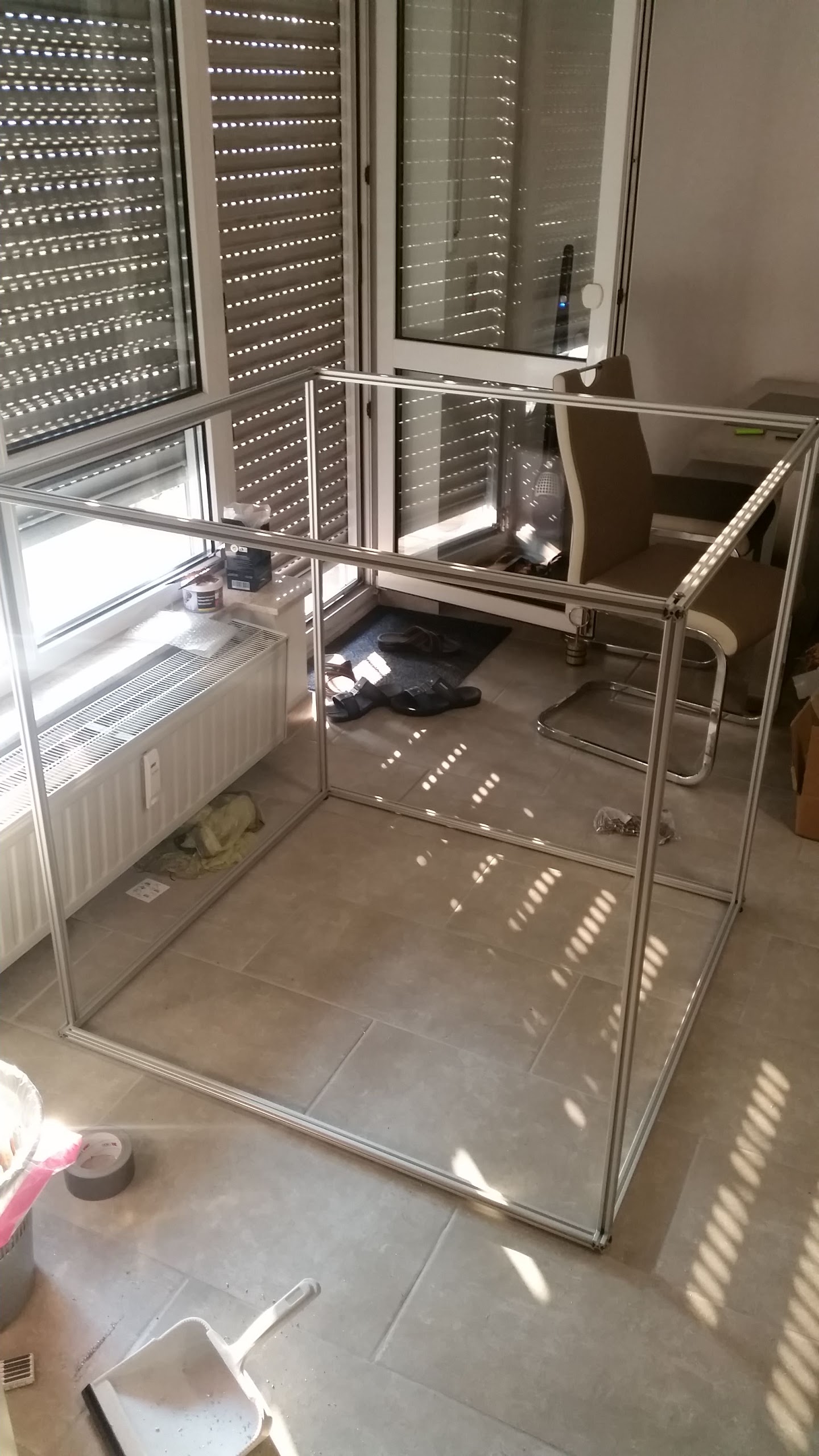

Is this to big?
1000mm x 1000mm x 1000mm
For the sized rails you have, yes. Those need to be at least 2040 or ideally 4040.
Yes , u are right. Was My first thought too. But this Printer Will be a closen one. I will screw 2mm polycarbonat plates on the sides, too get stabilty
It’ll flex like a gymnast. Even with PC covers
Really? It will be fixed at 5 points per rail.
The polycarbonat Starts to bend at 260 degrees
Yes.
Add some Dyneema in the diagonal at the very least…
@shauki
U mean the quadrap corner spec is less flexy?
(Deutsch)
Ist das Verfahren der Verstrebungen beim quadrap weniger flexibel als wie ich es getan habe ?
@shauki , no such thing as too rigid.
