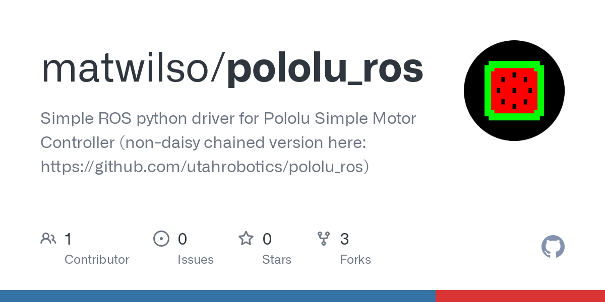

I did a quick search and didnt see a TIC T500 stepper controller driver for ROS but that doesn’t mean it doesn’t exist. There are several examples of ROS drivers for pololu steppers.
